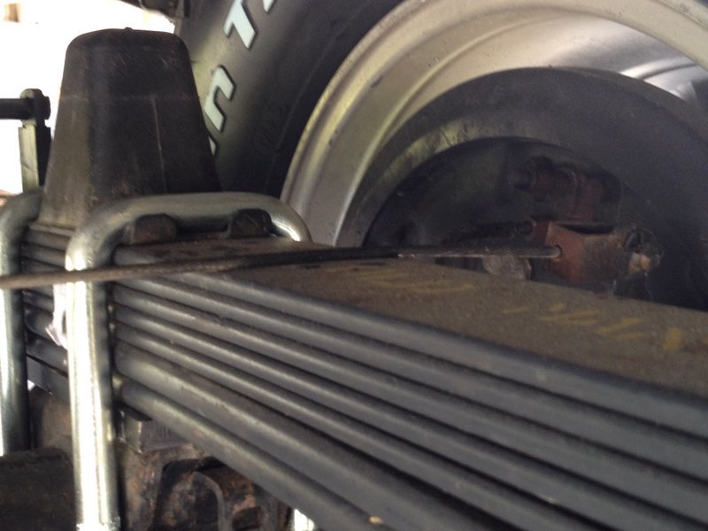

    Mine rubs too, haven't done anything about it though as it hasn't been a problem.
    You could make an extension for the arm off the drum to raise the cable if it really bothers you.
    http://www.bajataco.com/Brakes2.html
