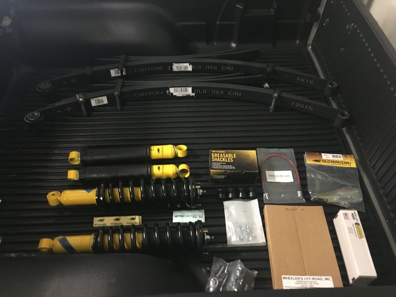

    Couldn't get to it today due to a 15 hour work day, but will get on it tomorrow!
