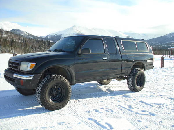

    OME 881, 10MM top plate spacer,nitros,wheelers 5 pack, 1.25 Daystar Shackles,265-75-16 Duratracs on 16X8 Pro Comps,leer shell, husky liners, sway bar removed, X-runner badges, tint, auto start, BPV relocate, extended rear brake line.
    OME 881's, Wheeler's 5 pack and Daystar 1.25 greasable Shackles with OME shocks on all four corners.

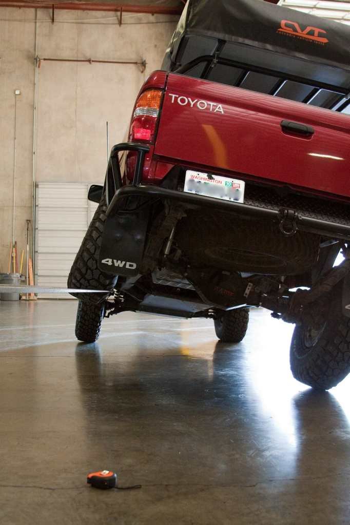

    ^^^ If you disconnect/remove your front anti-swaybar, your left rear tire would not be lifted in the air like that.
  19. Mar 17, 2013 at 9:39 PM
    #319
    01kingtaco
    01kingtaco Well-Known Member
    Sep 20, 2012
    #87393
    259
    Kodiak
    Maui hawaii
    01 taco slightly modded
    Bigger tires, sound system, deck plate mod, fog light mod, straight pipe exhaust, blue led floor lights, ultragauge, 3 inch lift
    people have been telling me that latly. when i replace my steering rack bushings i think im gana pop it off and see how it rides. i just dont wana have body roll at highway speeds but sombody told me cuz i got 883 coilsprings that those will help with that.
  20. Mar 17, 2013 at 10:53 PM
    #320
    scocar
    scocar Patron of the Farts
    Nov 11, 2009
    #25814
    40,080
    With 883s, it should be negligble. I did it with 881s, and it was much less noticeable than I thought it would be. You notice it more in off-camber turns. Just try it and take it easy and you'll see.
