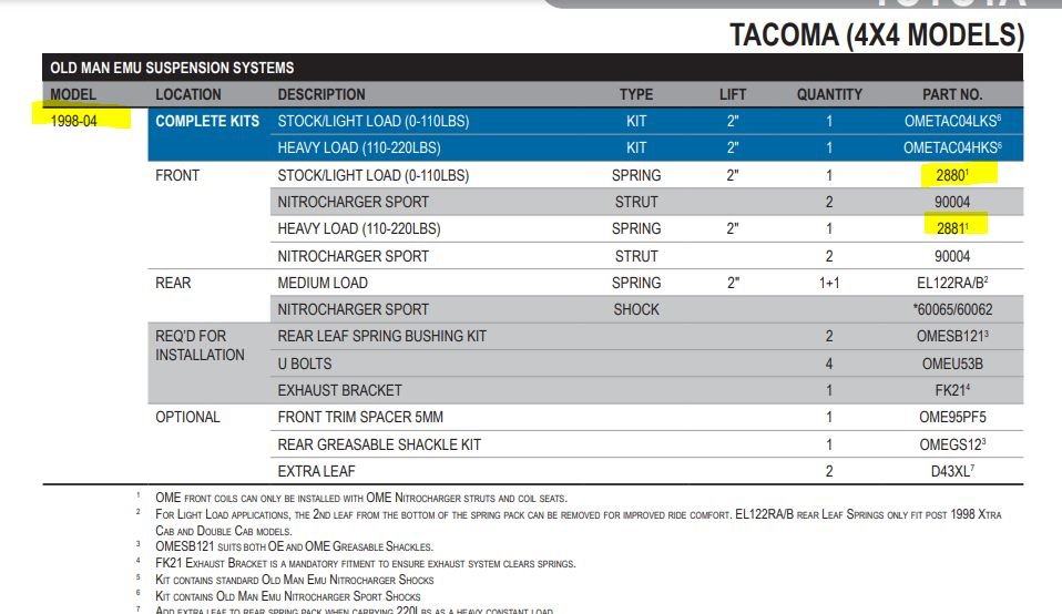

    So I'm chasing down a few question marks I had on upgrades and one of them is the correct coils I should be running. With the added weight of the 4WD swap, doublecab 6cyl, ARB and plan to add sliders and a winch - these 881s are going to be really feeling it.
    Checked in with ARB USA Support via phone. After a quick rundown of what I currently have on the truck - he said quite frankly,
    "881s are the MAX spring we offer for the first gen tacoma. People run 882s and 883s but they aren't meant for the first gen tacoma."
    Say what Jared? o_O
    Ended call w Jared (I think he wanted to GTFO and go to lunch) and called up Wheeler's instead. I ordered the full kit from them back in 2018. Asked if Josh was still around but he isn't with them any longer. Sucks, he was a cool dude who enjoyed talking with the customer. Anyway, the rep I spoke with said the 881s I should definitely replace and he suggested the 882s. He said the 883s would work but would produce a rougher ride and potentially mess with my CVs. I asked about the trim packer (currently have a 5mm on the driver's side) and he said it should be the same.
    So looks like I'm going to order up the 882s.

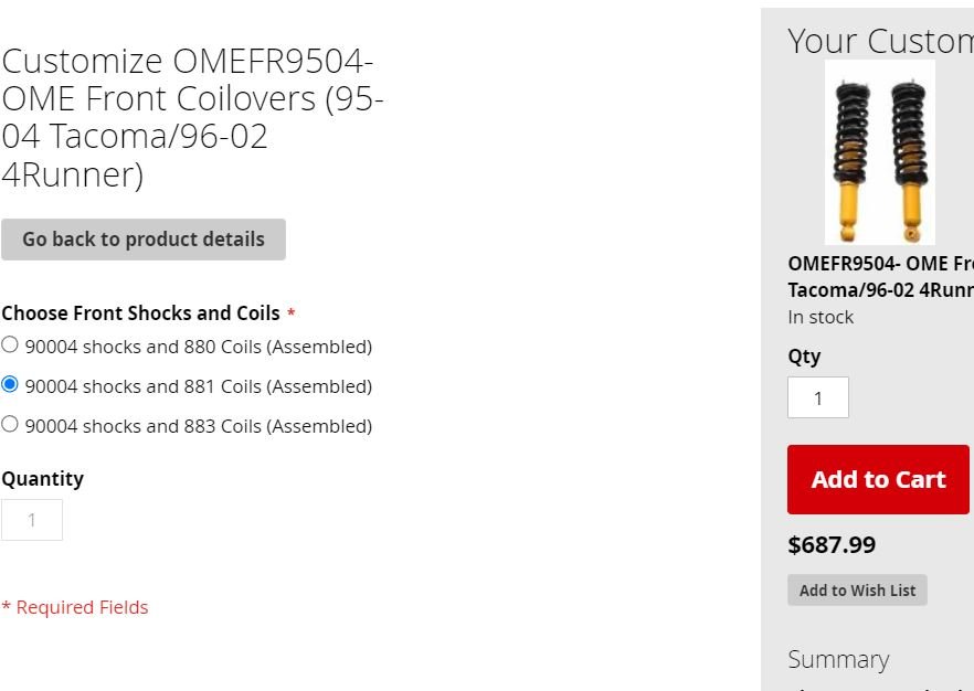

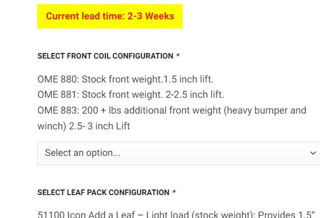

    Since my coilovers vanished in transit (UPDATE to this as of 12/21), I've been trying to locate another vendor to order from since Wheeler's is taking their sweet time resolving my order.
    I can't find anyone else who is configuring with 882s anymore. Even ARB only shows 880 and 881 as an option. Wonder why the change? Perhaps ARB finally pulled the plug on 882s and the first gen simply due to lack of demand/sales? Headstrong only lists 880, 881 & 883
    YotaMafia only lists 880, 881 & 883
    ARB's Vehicle App pdf only lists 880 & 881!

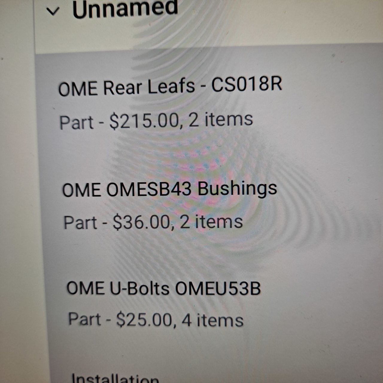

    I'm going to order these rear springs, old man's for my truck this week,
    Anyone have any problems with them?
    CSO18R
    1997 reg cab

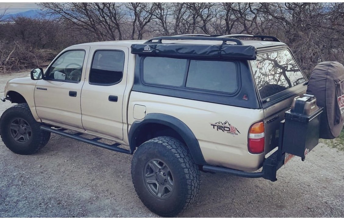

    Late to the party. 882’s with nitro chargers up front Dakar W/ AAL in the rear. B3C393B4-06FE-44A8-A254-05C06BBDFF3E.jpg
