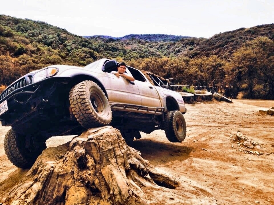

    Oh, and I did manage to do this with my ome susp.... Note the tire off the ground haha. hudupetu_289391dae27fa232d6c66a6dbd8c514207d47b40.jpg
