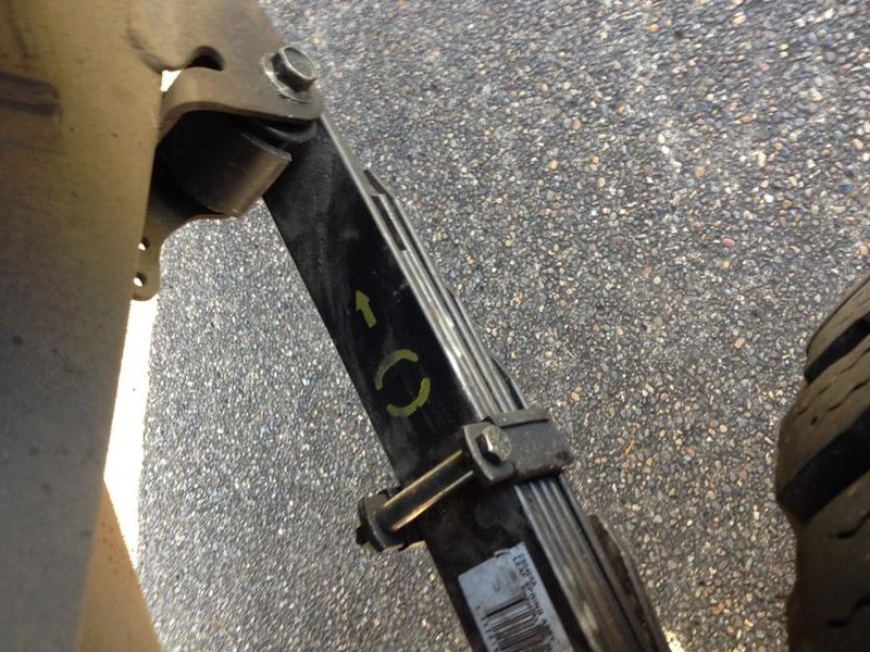

    I thought the same thing. What symbol did your springs have on them? My drivers side was positive (+) while passenger was in spec (O). Is your lean noticeable to the untrained eye? Or is it fairly obvious?

    I've got two o's. My left rear measures 25in from center of hub and my right rear measures 25.5in. Not terrible but unexpected

    There is nothing wrong with them. However OME has separate leafs for each side. You have 2 passenger side springs. The drivers side spring has a slightly higher spring rate to account for all the extra weight on the drivers side

    Hmmmm, well they have the different a and b endings in part numbers to distinguish which side they are for. I thought the O and the + meant if they were at spec or higher. Shouldn't the a side have more lift than b anyways due to higher spring rate?

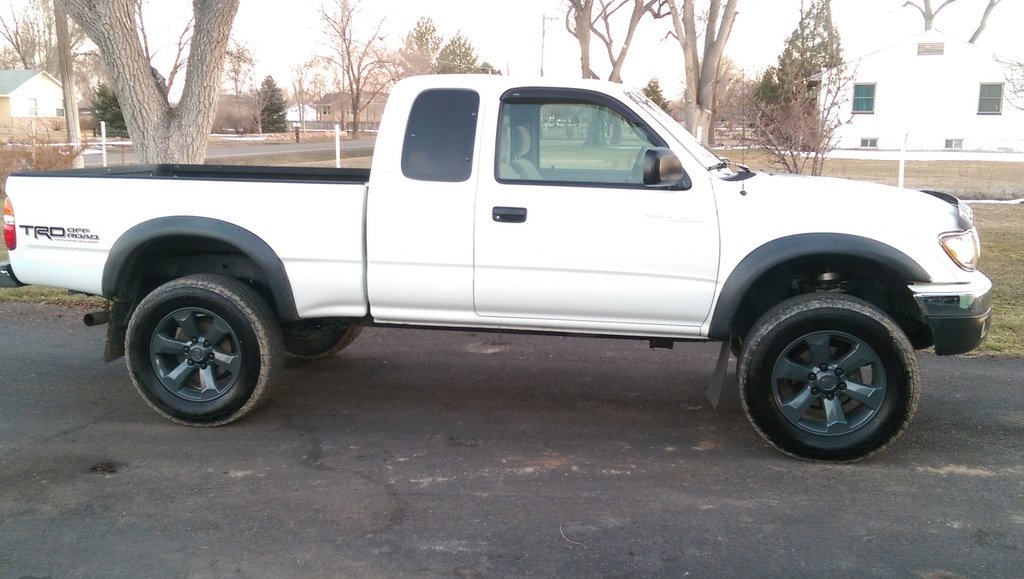

    Okay thanks for the tip lol But in the mean time got my new wheels and tires put on! 285's fit with the crappy spacer lift i have! :D
    Before:
    After:
