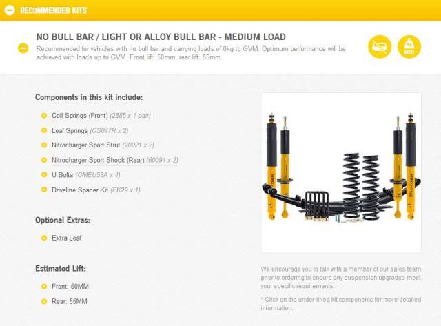

    the wheelers listing does not claim a 2.5" lift.
    in fact, the description for 885 coil states
    Lift Info:
    05+ TACOMA:
    - Provides approximately 1.75″ lift on a stock Tacoma 4×4 with no Bull-Bar or Winch.
    It seems nobody makes longer coils that will provide 3" lift on a 4x4 2nd Gen. and all say to add spacers to get the full 3" lift, knowing how bad spacers are, this completely defeats the purpose of getting the spring.
    eibach only provides 1.6" lift on 2nd gen, and toytech sells spacers to get the 3" lift.
    actually, the same eibach coil provides a 3"lift on first gen. without spacers so I'm thinking they just never designed or manufactured newer springs for the 2nd gen and just sells the original/old springs as is and tell you to add spacer or bump up the 5100 to 0.85 to get 3" (1.6" + 0.85" + 0.5" spacer ) on 2nd gen. Seems to me like paying a lot and not getting an optimal solution.

    You'll get 2 1/4 - 2 1/2" lift from 885's

    Yeah , I know
    You'll get more like 2 1/2" , everybody does
