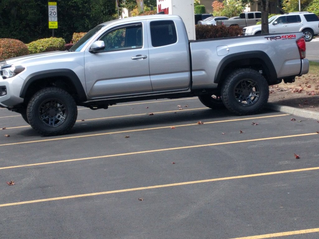

    Currently i'm currently running 3rd gen Bilsteins at the 4th setting , and the truck is sitting pretty level. Sitting a hair over 37" front and back from ground to bottom of fender wells....so i got a hair up my butt and ordered 887's , Headstrong 3 leaf aal , rear Bilsteins, 1/4 top plate for driver side and LR uca's. I'm hoping to be right at around 38.5" after the install. My only concern at the moment is the size of my tires...265/70/17...here's a quick side shot of the truck as it sits now. Pics after the install next Tuesday...

    For crawling not hauling
    You measure from the middle of the hub.

    If you measure from the center of the hub to the bottom of the fender it removes your tire size from impacting the calculation. Having 38" from ground to fender on 31" tires isn't the same as having 38" ground to fender on 33" tires.

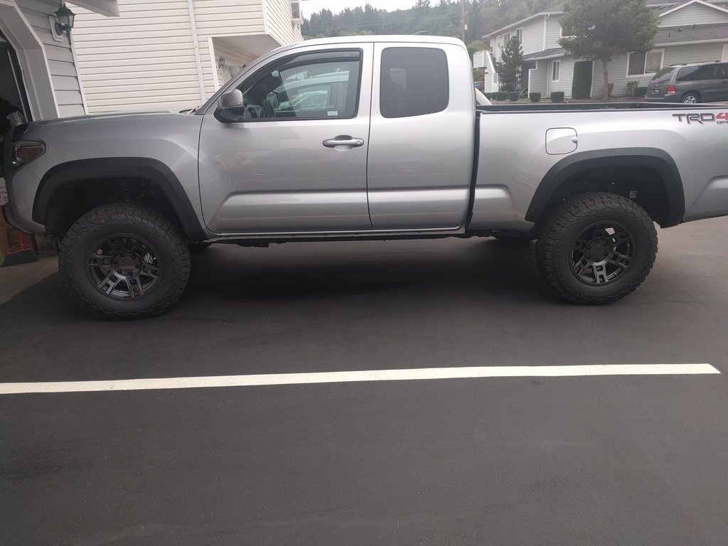

    Very important that the Bilsteins are set at the lowest setting...0. There was a mistake with my install ,where they did not do this . It was a noticeably harsh ride. I had it corrected quickly and all is good now. Very nice ride....here's just a quick picture
