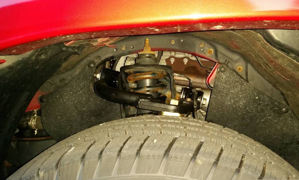

    i'd consider the icon tubular UCAs vs the ones from LR.
    i don't have exact alignment specs yet. i'll have them tomorrow and will edit this post to reflect actual measurements. what i can guess:
    camber: 0.3
    caster: 3
    toe: 0
    due to the new ucas, caster goes way up. it tracks so well on the road i can't believe it's my truck. why don't the trucks come from the factory like this? the new ucas also keep the steering controlled - some may consider the steering 'stiff', but i think that the steering is way better than stock. fabulous.
    camber stays at 0.3 because of the lift. the lcas are all the way out and i'm at 0.3. i think as soon as the 884s settle a little, the lcas will come up and camber will come very close to zero.
    i am also on Armorology's waitlist for a new light bumper and winch setup, weighing about 150lbs total. i think that will also bring down the front a little and bring camber to zero.
    actual alignment, post icon uca, on ome 884 setup in front and dakars in back:
    ---TBD---
    here are pictures of the current setup in the front with the new icons:
    my taco is driving better than ever after these upgrades.

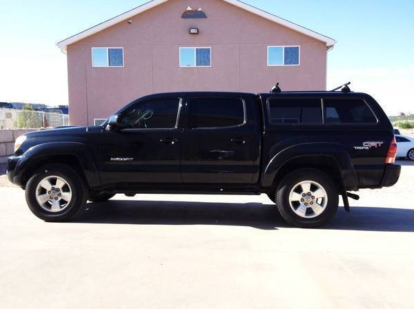

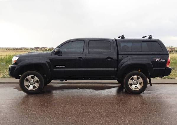

    I finally completed my lift after two years or so. I installed Light Racing UCAs and purchased 265 70 R17 Michelin M/S 2 tires. I like the way the new tires fill up the wheel wells a little more. Definitely better than the factory Bridgestones. The best thing is, it drives like a new truck! If you are on the fence about replacing your UCAs...DO IT...you will not be disappointed.
    BEFORE:
    AFTER:

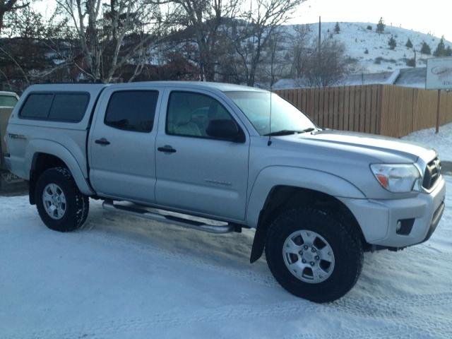

    Thought I would add none as well to this thread. This really helped me decide what I wanted. I replaced the stock tires with 235 86 16’s as well.
    Stock:
    Passanger Front 20.5"
    Driver Front 20.5
    Passanger Rear 21”
    Driver Rear 21”
    OME 884’s, 90021’s, and Dakars with the long overload removed:
    Passanger Front 22.5"
    Driver Front 22.5
    Passanger Rear 23.5”
    Driver Rear 23.5”
