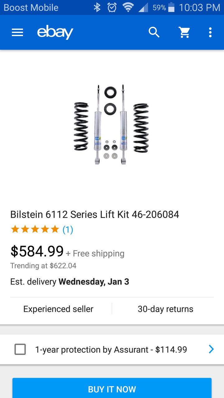

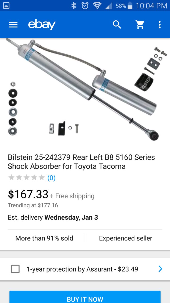

    Hello everyone,
    Anybody has Bilstein 6112s and 5160s on their Manual Tacoma?
    How's the ride? I considering this set up. Heard so much positive things about this but curioua if I am going 2", 2.5" or 3" front and 1 or 2" rear.
    What did you use to lift the rear? AAL or Block?
    If AAL, how's the ride without any load from the bed?
    What's the preferred notch on 6112s?
    How's the ride?
    I am looking at 265/75/16 AT3W...
    Any feedback will be appreciated.

    Hope this 1 will help for some questions.
    1. The part number shown in your first picture is for the Tundra.
    2. Read this thread: https://www.tacomaworld.com/threads...112-5160-with-3-leaf-aal-for-1-5-lift.486379/
    3. Talk to Marie @HeadStrong Off-Road.
    4. Here's the lift chart for the 3rd gen 6112s:
