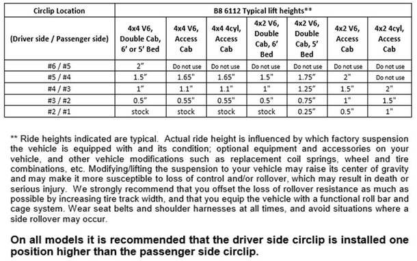

    Why are the notch’s set at different numbers for the passenger and driver sides? Wouldn’t you want them even?
    Also, could I run 5100’s on my 2018 4x4 Double cap V6?

    The driver side is heavier with the battery and gas plus the driver. Bilstein was smart enough to offset the “Taco lean”
