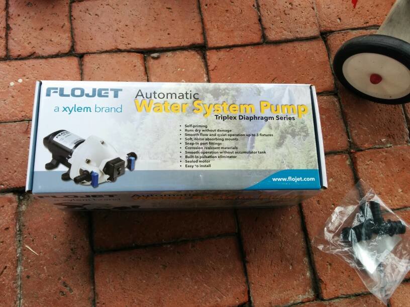

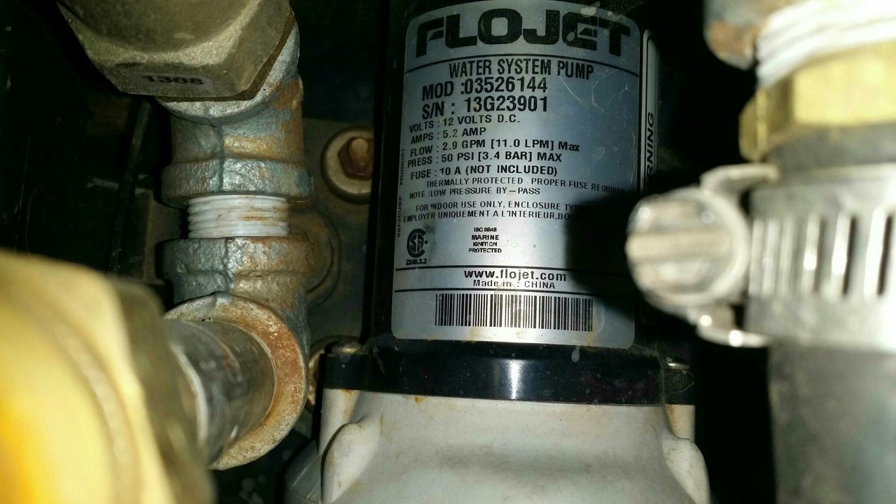

    I see that a Moen thermostatic mixing valve is being offered by Amazon now. I have also found that the mixing valves which offer the higher output ratings (100* - 145*F) are more difficult to find. I've read a number of reviews on Amazon about the Honeywell ones with the lower rating (100*-120*F) and there are complaints that when dialed into the hottest setting they don't output water temp at the stated upper range, even when the source is plenty hot, the end result is water that's not hot enough... (I know this is not an issue for individuals using the output of the valve as an input for a truck mounted shower :) )
    On another note, I ordered my pump (Flojet 03526 144A), strainer, and a few fittings. It appears that flowjet utilizes a quick-connect system for attaching fittings to the pump. They call them 'quad port' fittings.
    This fitting allows you use a garden hose for an input or output to the pump:
    1/2" barb to quad port fitting:
    Sample image of a quad port with 1/2" fitting and 90* bend.
    What I also like is that the pump is serviceable, the pressure switch can be swapped out, if I ever wanted to go from 50psi to 25psi, simple part on top of the pump. The pump specs document was helpful when looking for accessories and parts.
    :thumbsup:
