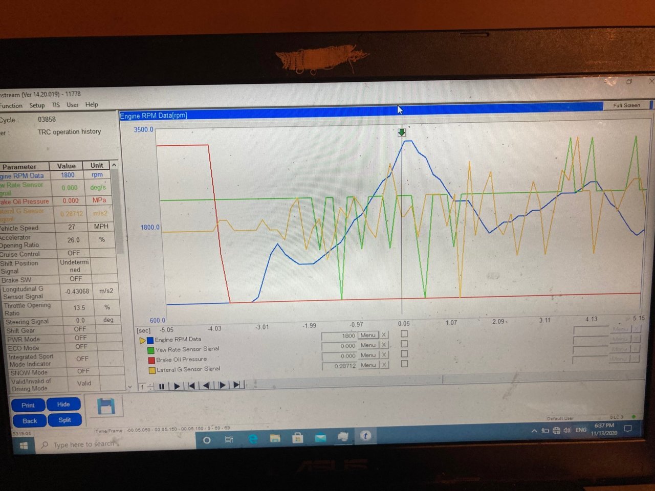

    With Techstream?
    Since your a '17 you can do things like turn off the seat belt chimes, # of times the turn signal blinks.. read ALL the live data from the truck and any stored codes that have not set off any lights.
    Your truck also stores every time the remote was used to lock or unlock the truck, pressed the panic button on the remote,
    every time the Traction or stability control systems activated (and it then stores a 10 second live data of everything from individual wheel speed, gear position, throttle position, g-forces, brake pressure etc at time of the event).
    Every time you stomped on the gas or the brakes....
    The 2020's keep a SCARY amount of data, as in tied to GPS street info with Camera and Microphone.
