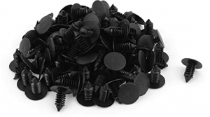

    Anyone know.thwnsize of plastic rivits needed for.the splash guards please.

    https://www.tacomaworld.com/threads...rd-rock-guards-template.621635/#post-21190923
    this might help?

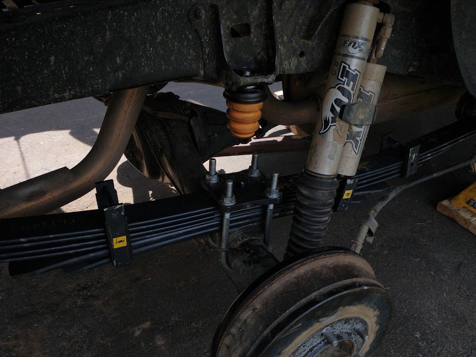

    Would most likely have to mess with it to make it fit. Easy to do in the rear since you can drill through the bump pad and have it bump on the axle (a flip kit plate is a better strike pad).
    I did this:
    https://www.tacomaworld.com/threads/fox-2-0-deavers-1-5-aal-and-gm-bump-stops.289215/

    I was intending these for the front possibly. Harsh front bottom outs are frequent. No significant added weight either. Totally band aid for current stock suspension and prep for new suspension in the spring hopefully.

    Only issue I can see with those is the bump has its own thread. This would need to thread into the stock nut. The super bumps are a bump stop with a hole in them that you thread a separate allen head bolt through.
    The bumps you sent though can be cut down so you can definitely make them work assuming they thread in to the stock location.

    you could probably make them work even if you had to remove the stud and get a bolt that threads into your Tacoma. keep in mind they are more than 5/8 inch shorter than the wheelers so depending on the softness you might have to shim them up a fair bit as well.
