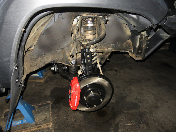

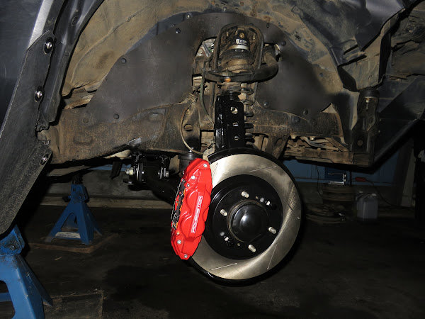

    Got everything installed:
    • StopTech 4Runner slotted rotors P/Ns 126.44174SL, 126.44174SR
    • Advics P/N AD0976 OEM-equivalent pads
    • PowerStop P/N S6278 reman 4Runner calipers
    • OEM 4Runner brake dust shields 4778160140, 4778260140
    • OEM replacement LCAs 4806804060, 4806904060

    Why did you replace LCA so early?

    The LCAs were squeaking loudly after the Marlin frame gusset install. The seized lower shock bolt on the driver's side meant the LCA couldn't be pulled away from the frame for the full weld. I suspect the rubber bushings got cooked.
    I saw the LCAs on ToyotaPartsDirect for 30% off MSRP, so that made the decision easier. Only drawback is they lack the plastic hole plugs (supposedly to prevent the LCAs from whistling like an ocarina at speed).

    hmmm interesting, I had Sumin welded those gussets without removing C/A, still brand new at 140K :notsure: just sprayed with water them after burning in :bananadead:

    Pavel was spraying water on them after welding each section, too. Evidently that wasn't enough cooling. :notsure:

    Here's the thread where I got my 4Runner brake upgrade info: https://www.tacomaworld.com/threads...unner-bbk-upgrade-for-2nd-gen-tacomas.504234/
    Enter 2010 4Runner SR5 in the part selector menus on all the parts web sites to ensure you get the correct calipers with the smaller mounting holes. With the All-Pro spindle gussets, I had no interference with the dust shield.
    StopTech quality is slipping! The rotors wouldn't seat properly on the hub register. Once I sanded away the E-coat on the center bore with a Dremel, they fit correctly.
