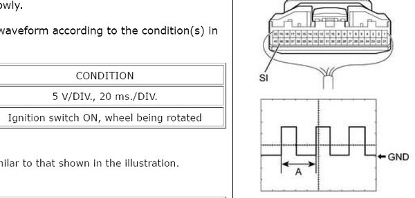

    Get 35s. Driving at 110, your speedo will show only 100, problem solved.
    Jokes aside, according to the FSM, the speed signal is a single 12V wire going from the skid control ECU to instrument cluster. With each wheel rotation, the skid control ECU pulls the voltage to 0V four times, forming a square wave. Both the digital display and the analog gauge get their signal from the same source:
    If the digital display is stable but the analog gauge needle is shaky, that is likely a problem with the gauge internals. Bad stepper motor, insufficient hold current, etc.
    To verify this 100%, you'd have to hook up an oscilloscope to the SP1 signal line and look at the waveform while driving at 110 kph.

    Appreciate it!!! I may have a missing tooth or something on the stepper motor. Oh well, I will ignore till truck burns down.

    ^Yes missing tooth or deadspot. Ask your former employer if they have an electronics shop (like United Radio) that can repair instrument clusters. Of course that's if you can accommodate the downtime.
    Or wait a year and potentially upgrade your problem away.
