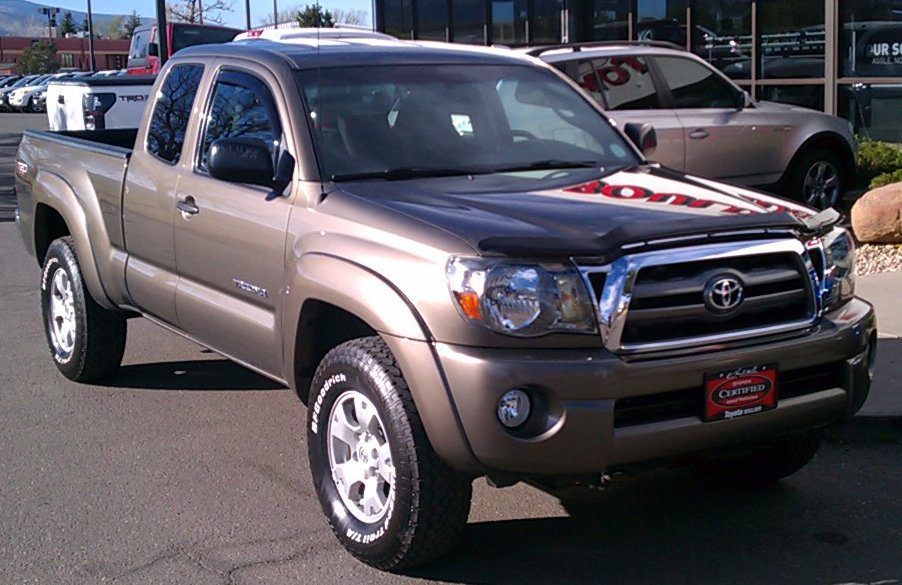

    So here's my truck the day I got it... all farmer John'd up. 22k or so miles and CPO'd for a screamin' deal from a Toyota dealership near me. It had a dealer installed TRD supercharger which is what I was looking for and, to be honest, was the last color I wanted. It's not that I dislike the color it's just that my most recent Toyota truck, a Tundra, as the same color. I had hoped to find something in a Speedway Blue or Radiant Red but when I found this truck it was simply a deal I couldn't pass up.
    The day I got it at the dealership:

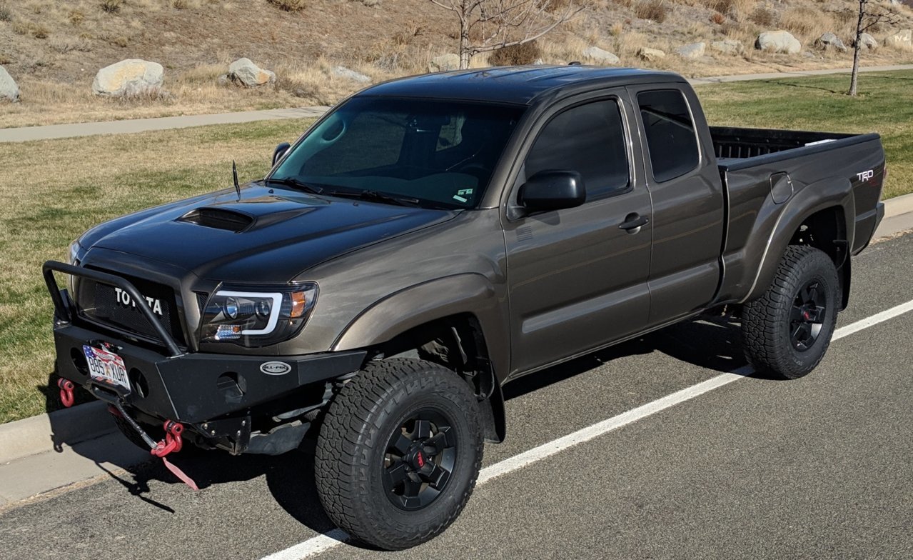

    Here's how it stands today after a few mods:
    4ijWwTrhve5u0h80vLYicgXywPAh2akfT8-QHftu_f6d558355a9d09c653699fb73ae45bbc18301df9.jpg

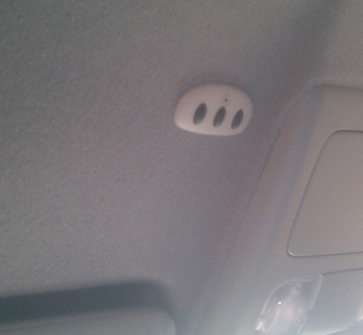

    Here's the Homelink module that I installed in the headliner. I picked it up at a junk yard for less than $20 and the install was pretty simple. Found a constant 12v inside of the overhead console and tapped into that and the ground for power. Then marked the headliner for the holes and cut out a diamond shape from the headliner for everything to clear. Then mount the module from the rear and snap the faceplate in plate to hold it and viola! Factory look Homelink!

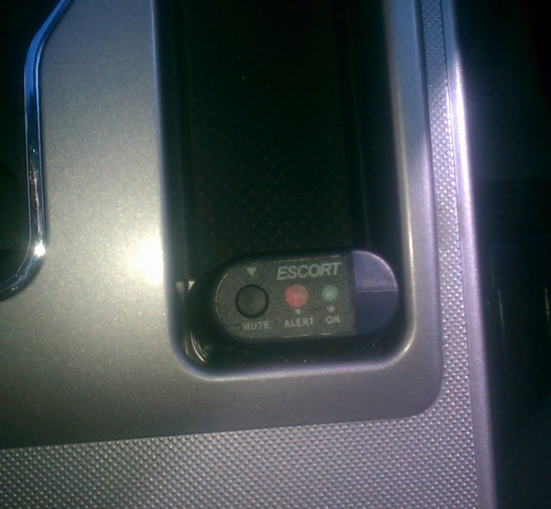

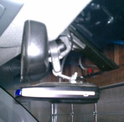

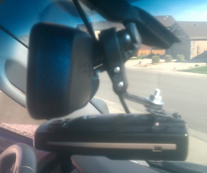

    Up next is the radar detector. It's a Passport Escort 9500xi w/GPS and I used a custom mirror bracket it to mount it. You can find the details to the bracket in my sig if you're interested but it's only a few dollars worth of parts. I then routed my remote mute button to the coin tray. Not the most creating mute button I've done on past vehicles but it works.

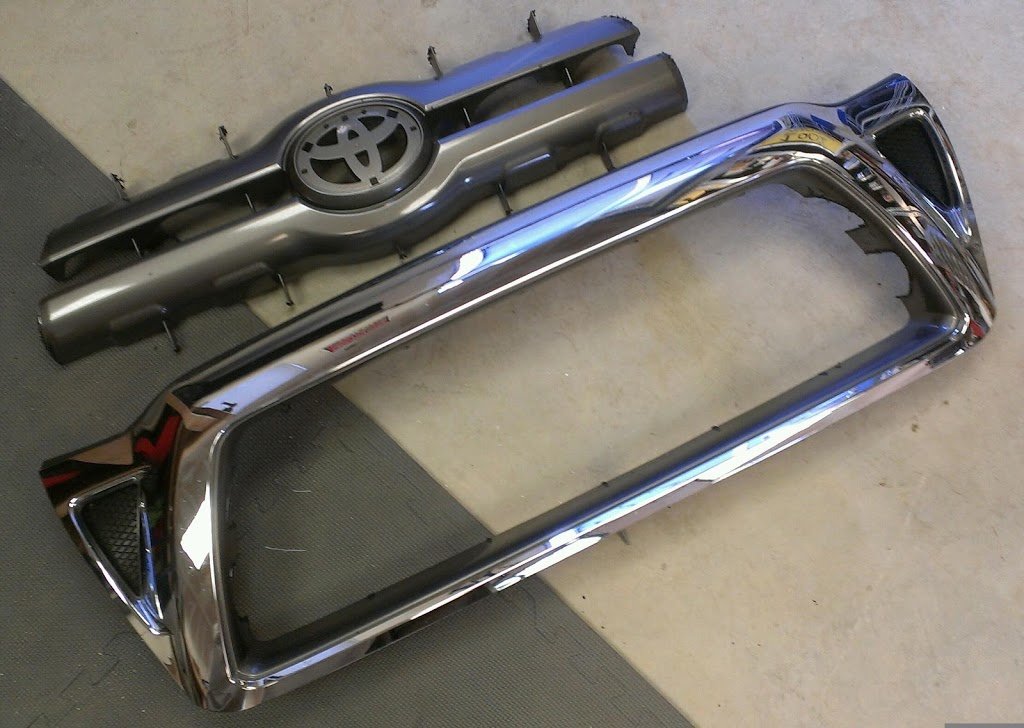

    Here's a few pictures of the Satoshi mod I did. Not too much detail but proof that I did it. lol
    Satoshi completed and paint done but not emblem:
    As it stands now w/TOYOTA emblem:

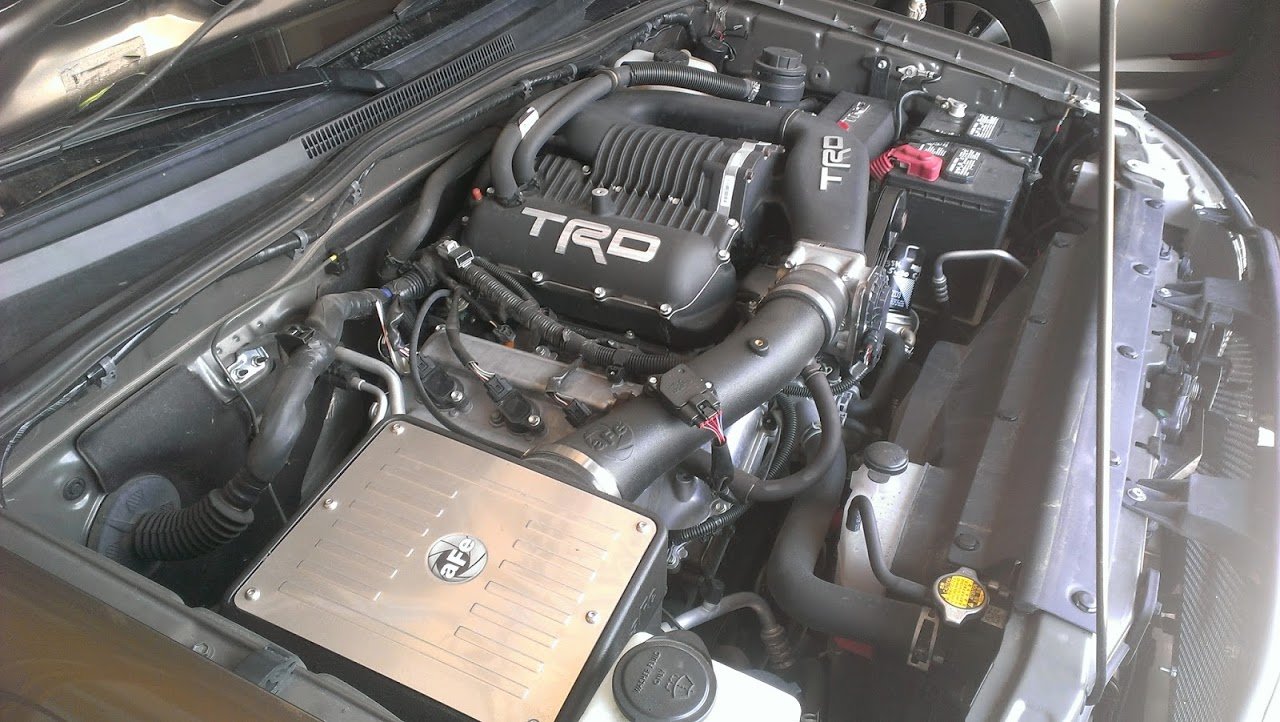

    Installed a K&N CAI to get rid of the stock airbox that I disliked the look of and then opted for a aFe CAI Pro Dry instead. Here's how it sits now:
