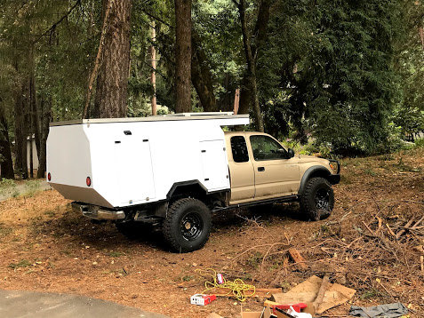

    I decided I've started enough mods that I should start a build thread.
    I'm going to start with what got me into my Tacoma. I do a lot of road trips. They typically consist of going to the middle of no where and camping. I frequently go out on the weekends to go backpacking and camp on the roadside on Friday night on my way to the trailhead. I found my self wanting to go to more and more remote areas.
    On one trip to Grand Staircase of the Escalante in a 2002 Subaru Outback we had to turn back on some roads due to poor approach and departure angles. The car just couldn't get down a lot of roads.
    I wanted something that could go down rough roads. I also wanted something I could sleep in. In 2011 I took up scuba diving. Here in Northern California you can only fit enough gear for 2 people into a car. So if you go with three people you need 2 cars. I wanted something I could carry gear for 3 people and the gear for 3 people as well. I decided I'd get a Subaru Forester or a RAV4 AWD.
    My search lasted about 3 weeks when I decided a small truck would work better. It was to be either a Tacoma or a Nissan Frontier. That lasted about 10 minutes. After that I had to decide on 1st or 2nd gen. I liked the smaller size of the 1st gen and the styling so I settled on that.
    After a year of searching I found this one at a local Ford dealership for $12K with 130,000 miles on it.
    This is the day I got it December 2012
    As it sits as of November 2019
    The next day the front wheel drive actuator went on it costing $800 to have it replaced. Since then it's had zero problems and I've added another 110,000 miles to it.

    The biggest project so far is installing an auxiliary gas tank out of a 1990 Ford F150. The tank will hold 19 gallons. I'm going to use the tanks built in fuel pump to transfer fuel to my main tank. This will give me a highway range of over 600 miles and more importantly an off road range of around 400 miles.
    Edit: As of September 2018 it's more like 500 miles on road and 375-400 off road. I've since added a lot of things that have reduced mpgs.
    It took me a solid hour along with some banged up knuckles to wrestle this bastard free.
    After I got it home I tested the intank fuel pump..it worked. The tank had about 2 gallons of gas left in it so I drained it. Next I wire wheeled and painted it.
    While at pick and pull I forgot to get a wiring harness for the tank. I could get one online for $55. This seemed like a lot being the whole tank was $44. I headed back to pick and pull and got this one for $4.
    I got rid of this switch a long time ago. It sucked. I installed this Radio Shack momentary switch in the center console. You have to press and hold it to transfer fuel. I figured this way I'm not going to flip a switch and forget to turn off the pump. I also installed a small LED indicator in the corner of my switch panel to let me know when the pump is actually working.
