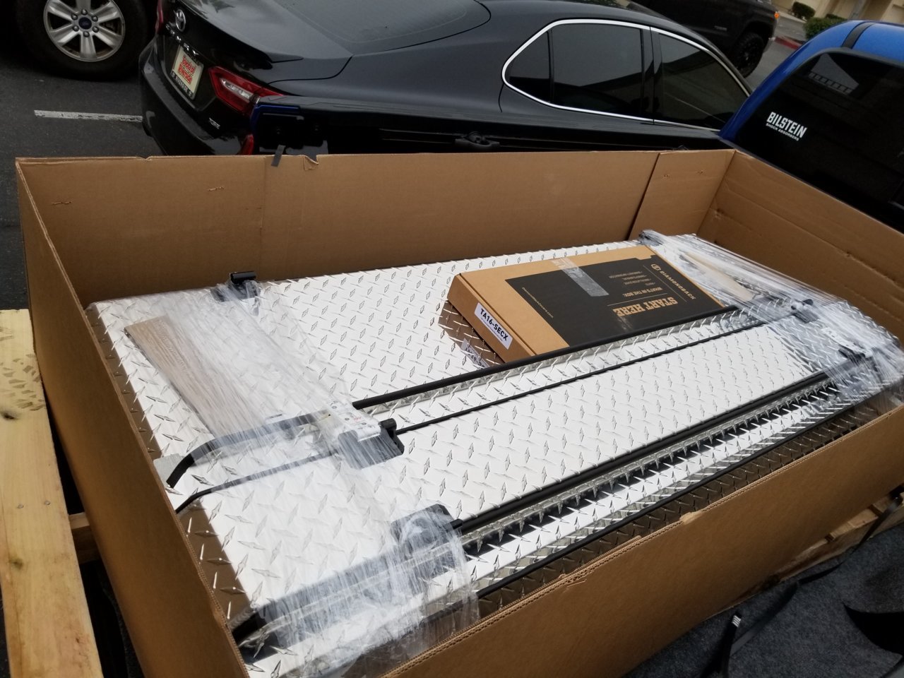

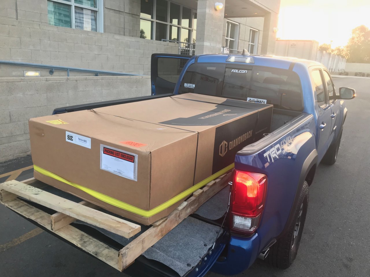

    Finally got my Diamondback cover~ Engineering will begin soon~
