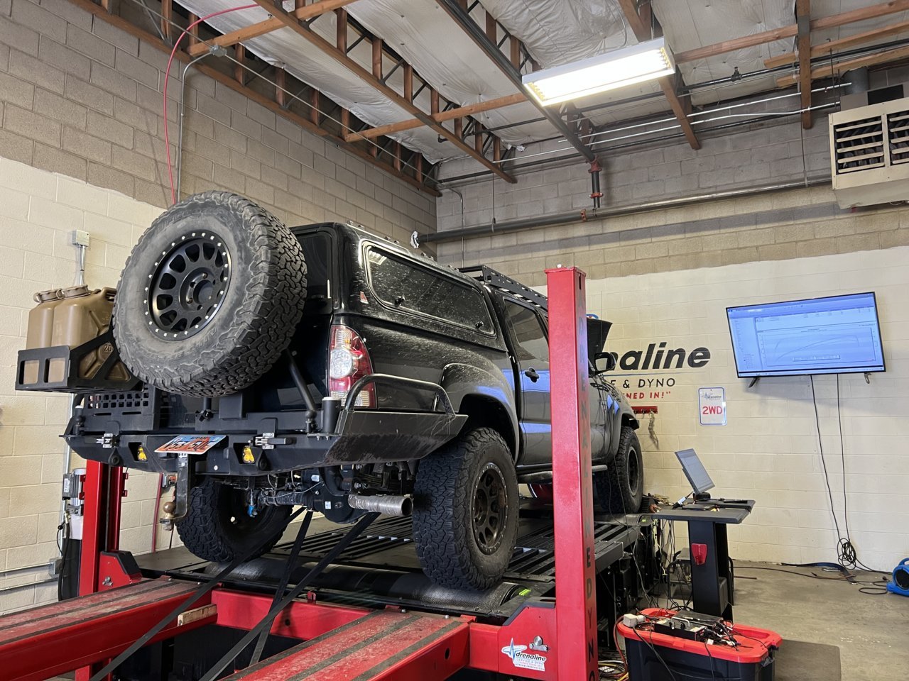

    Just got off the rollers with a 2015. Stock with a 2.7” (68.6mm) and a fuel pump. 34” tires and 4.88’s. Baseline was factory TRD tune.
    Had a wicked clogged Air filter. Picked up 20hp replacing it..
    https://youtu.be/C28dfL0RBNs
