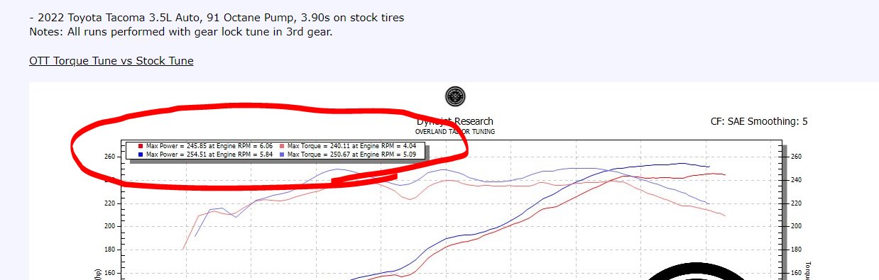

    You can't really compare the avalon and the Tacoma. The Avalon has an 8 speed transmission, so that alone will let it manage the gearing better. Couple that with the truck being heavier, less aerodynamic, and any mods you've done that increase rolling resistance, weight, or rotational mass, and you are comparing apples to oranges. Get that comparison completely out of your mind as it's totally invalid. The same engine in the vehicles means absolutely nothing. Don't compare them.
    For the dyno, don't look at the graph. Look at the numbers, and convert them to percentages gained. This pic is from the first post in this thread, and you can see the HP gain is about 3.5% and the torque is about 4.3%. All Dynos and all Dyno runs are not created equal, so saying "It gains 8 HP and 10 lb-ft" doesn't actually mean much because the exact truck on a different dyno might read it higher or lower in the direct numbers. What matters is the percentage gain. Now, this dyno is for a 91 octane, so you may not be able to get the same amount on 87, because the timing wouldn't be able to be advanced as far without knocking. Those numbers also aren't going to tell you what it will feel like because how it feels is completely subjective.

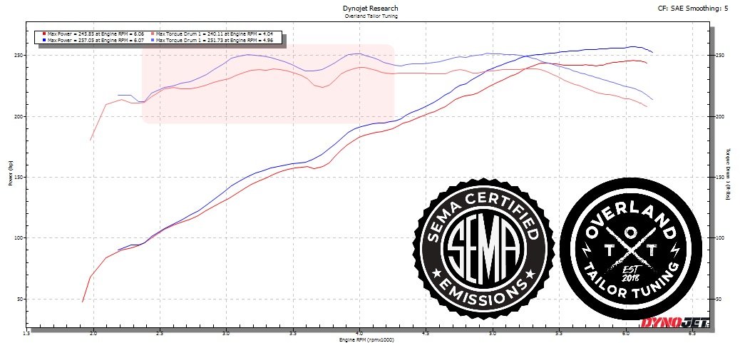

    Looking only at the peak dyno values does not tell you much beyond where the truck performs higher in the RPM range. Those are still important values, but not sure most drivers spend much time at redline where peak HP occurs.
    What really matters for the 3rd Gen Tacoma is what’s highlighted below.
    Having peak torque occur lower in the rpm range, where people actually drive their trucks most the time is what matters. Looking at peak values only tells a very small part of the story for a dyno. Same with only focusing on HP. Torque is what your butt-dyno feels.

    Very true! I should have pointed that out as well. I was just avoiding the graph Parr and completely glossed over that. Great catch!

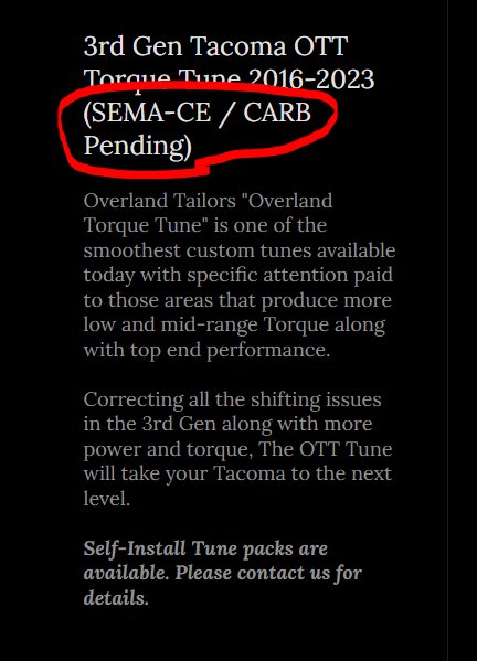

    Thanks guys. I knew in my heart that a Tacoma's powertrain isn't gonna feel like a car with a completely different transmission and factory tune, lol. But what about smog? Would I have to go back to a tuner and get the factory tune flashed to pass a smog inspection whenever my truck is old enough for the DMV to require one?

    That would be better answered by somebody who is.... not me. My state has no such nonsense, so don't take my word for it. That said, I don't think so. Go here and read up. https://overlandtailor.com/
    Pic from their site

    Where are you located? OTT’s 3rd Gen 3.5L Naturally Aspirated tune is SEMA certified for emission compliance which is recognized by 49 states. OTT has submitted to CARB and is pending approval, at which point the OTT tune will be full 50 state emission compliant.

    NorCal. I actually completely forgot about the certification until you brought it up, lol

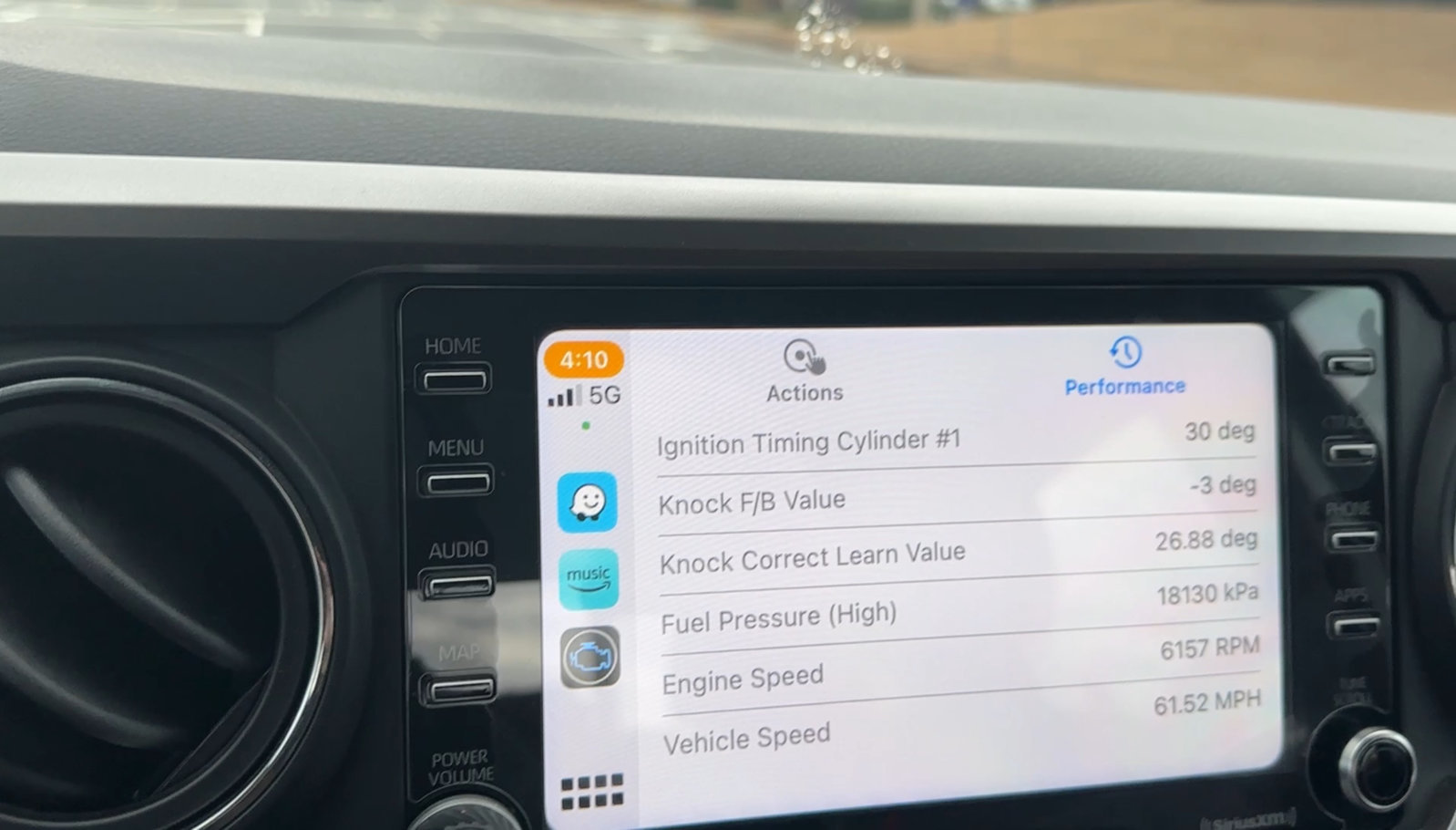

    Looks like OBD Fusion just added CarPlay support for those interested. The refresh rate seems to be a little better after playing with the settings. Still not great but for my needs it works.
