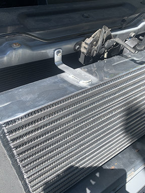

    yessir I did, I plan to pie cut 3” from there, but I’m done for now until I’ve got the turbos mounted.

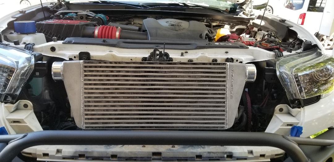

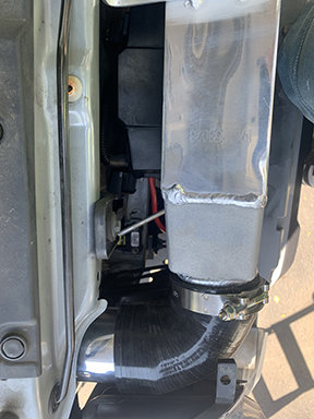

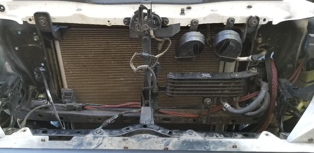

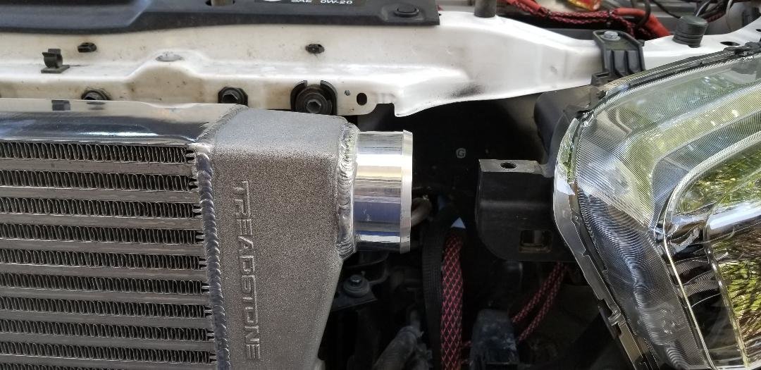

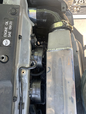

    Well, I've had the first window to tinker on the taco.
    Hopefully anyone else that wants to run this setup can benefit from this research:D
    Test fitting the drivers side OEM airbox. So far everything is fitting very well. Just need to run some heavy AWG and relocate the battery to the pass side. Does not interfere with factory fuse panel.
    90 ° off the original intake output should put me right down to the drivers turbo inlet. I feel much more comfortable using a OEM air filter, along with the air box which has a water drain at the bottom. shout out to @Schwartz !! for the air box hookup
    Next is the FMIC. Props to @Turd Hawg for the gorund work on sourcing the size. It's a Treadstone TR1035. Beefy core and should be plenty.
    First mock up.
    As you can see, I have a winch and a LB fab bumper. I wanted it ~2" above for clearance and everything is fitting perfectly.
    Removed the little plastic side wind directors. I might be able to keep them but not a priority right now.
    90° Off each end clears the headlight mounts(I did not want to alter them, as my grill locks into that)
    Just need to pop a hole in the radiator support wall.
    Pic of how high my winch sits
    NO modification to my grill. Fits right around the FMIC PERFECT.
    Even able to retain my 4 HELLA horns
    [​IMG]'
    Although, I did have to drop my trans cooler a little lower.
    And the look we are all going for!:rofl:

    I wonder if 1" flat strap "x", welded flat would beef up the area around the hole through the radiator support. I know that's a weak area of the truck when wheeling.

    Is there any concern here with how much of the stock radiator is blocked?
