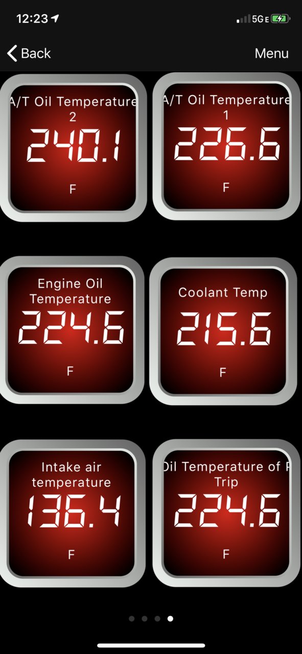

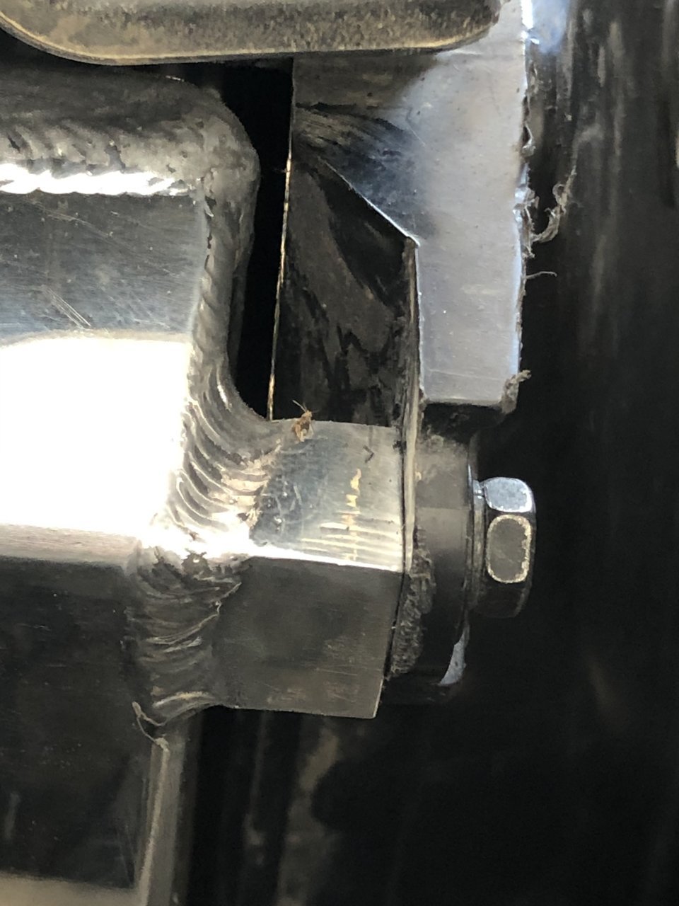

    @MESO not the best but the Top mounts and possible bottom stick out too much and you can’t get a good enough seal. was able to get the top on but the gap is small but it basically renders the shroud useless. You do have to play around with the fitment but you can get the top plate back on. grinding it down 1/8-1/4 or a seal is needed. Have not seen anyone cut it down. I debated.
    this shows the corner of the space.
    This was my temp on a hot day (90’s) Sitting in a drive through. Fan was useless. A trip through weekend before caused my trans temp light I come on and that’s hard to do 300+ happened on a steep grade in 4wd. Temps were prob already high and cooked it.

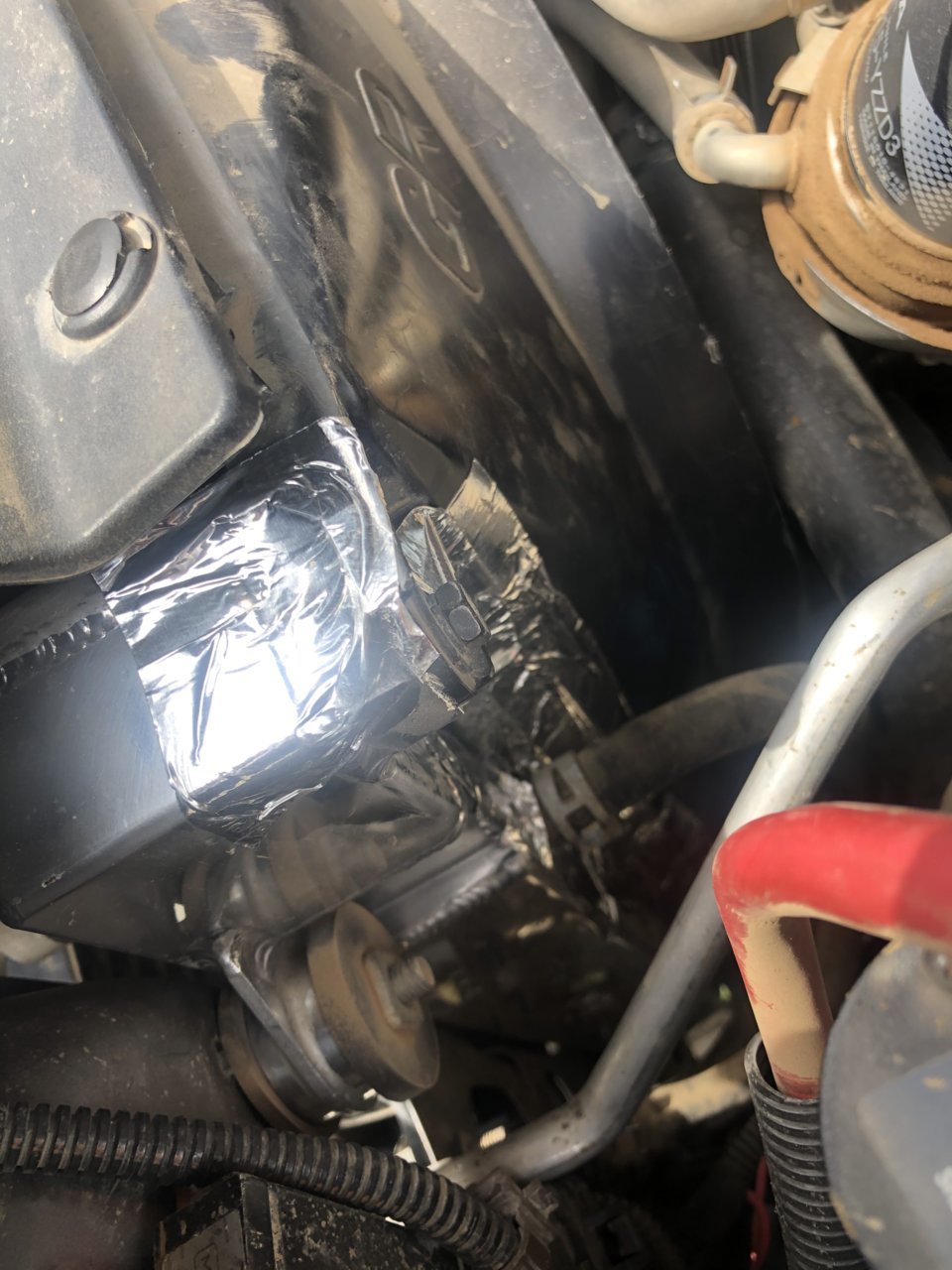

    To test my theory I used some HVAC heat tape to block the spacing.
    temps after with some WOT etc to get heat up. Def need a bigger trans cooler but way cooler.
