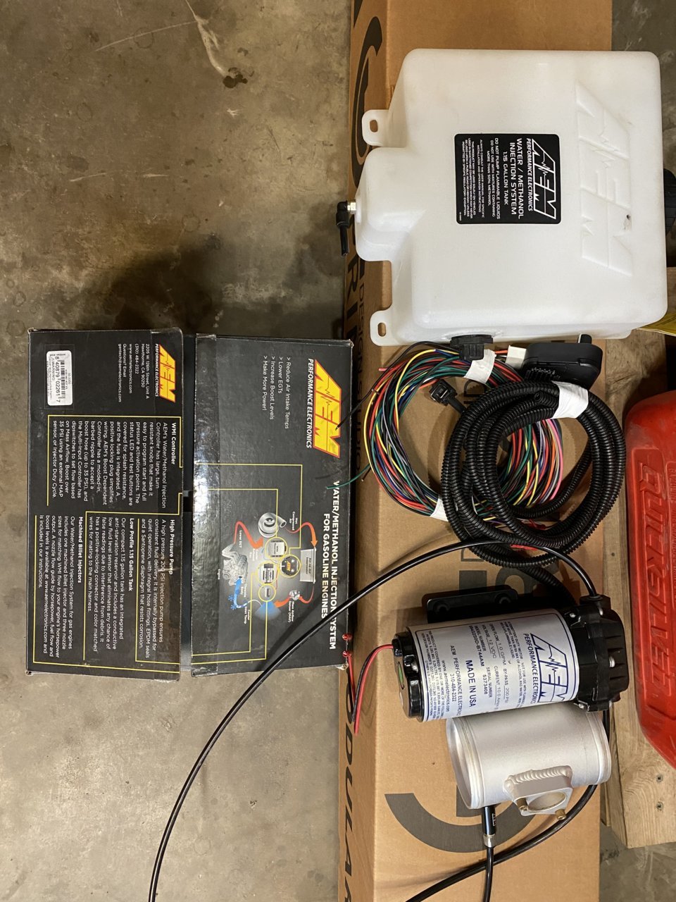

    My set of Mark 6’s just arrived a couple days ago from West Kendall Lexus to a friends place in Leander, Texas. She will be shipping them out to me tomorrow (Kendall Lexus wouldn’t ship to Canada). I won’t smile until I have them in my possession. Cobb turbo blankets and all heat sheathing, barrier, wraps etc just arrived from PTP so I think I’m ready to go once the kit arrives.
    Pulled out the methanol kit out of my 2nd gen but still deciding whether or not to put it in the 3rd. Thinking 12-14 psi is sufficient and there’s no need to make another impractical truck.
