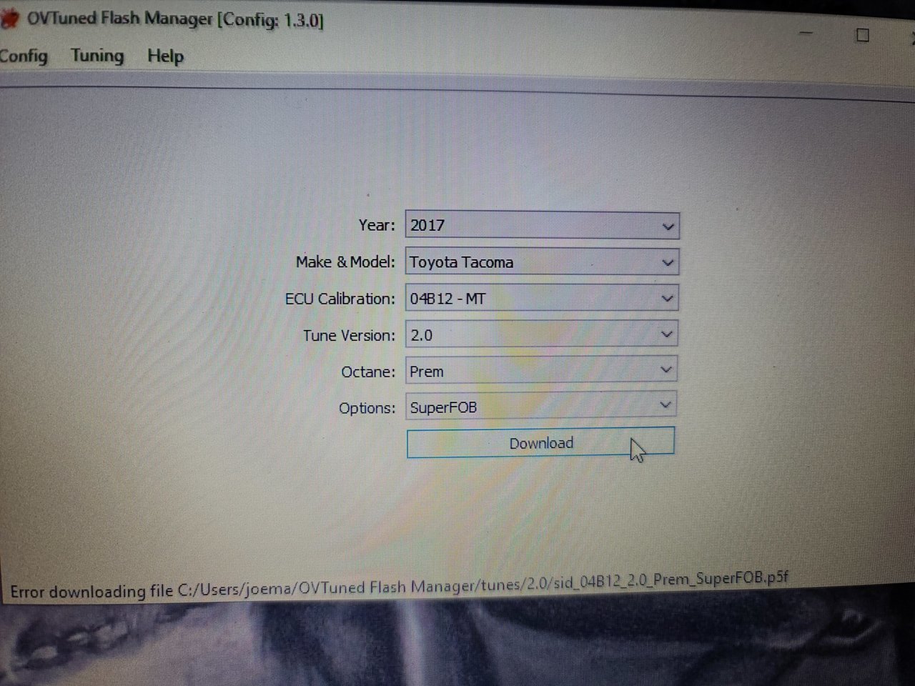

    So I've read through alot of threads and I've tried a lot before I posted this. I've tried to delete and reinstall the latest fm 1.3.0 I have all the virus and firewall turned off. I've purged , applied all software, etc..etc... and I'm getting the same error code every time. Everything was going smooth until trying to downloading the tunes. I've emailed Matt at ovtune but still haven't heard back yet so trying this. Thanks for any help. 20201123_194844.jpg

    They're linked in the main thread. The download through the app doesn't work for 2.0 yet since they're not fully released, last I checked.

    So it won't load 1.05 either. So how do I find the link for the main thread.

    @tonered @Shellshock
    One of these guys may have the files you need
    You need to update to 04b13 or 14 as well

    The tunes are not available in FM at the moment. @OVTune is updating it for the Final release.
