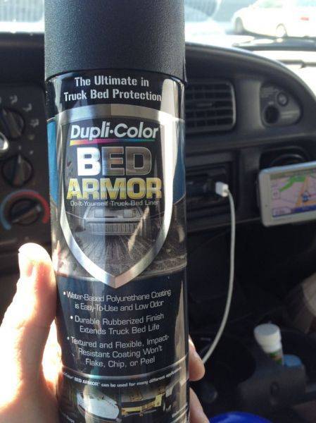

    I spent twice as much time & money priming and prepping the soft topper frame. I think spray bedliner is better used for small touch ups and/or hard to reach spots.
    I wish I would of listened to the members who told me how shoddy that stuff is. Here is the can i used. $22/can all for nothing...

    Bed Armor is only $12 at AutoZone
    But I would never use that on sliders. Hopefully you're going to get rock rash on your sliders, it doesn't matter what you use to finish them, it's gonna get scratched off and destroyed. Might as well use rattle can paint or enamel for ease of touch up.
