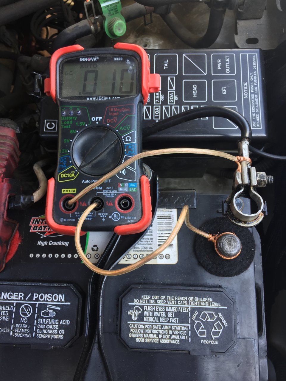

    Within a few seconds of connecting, the ammeter settled to 10mA and stayed there for around an hour until I disconnected it today. The truck does have a flashing red LED on the dash, that may have been most of the drain. I suppose this measurement indicates the factory onboard electronics are a pretty light load, which is good to know.

    @tacoma_ca: 10mA!! That's great! I'm far from that sitting at 210mA. Sounds like you've got a solid electrical system from what I can tell (I'm not a EE or anything). Please knock on some wood for me.
    Thanks so much for checking your system... now I have something to shoot for!
