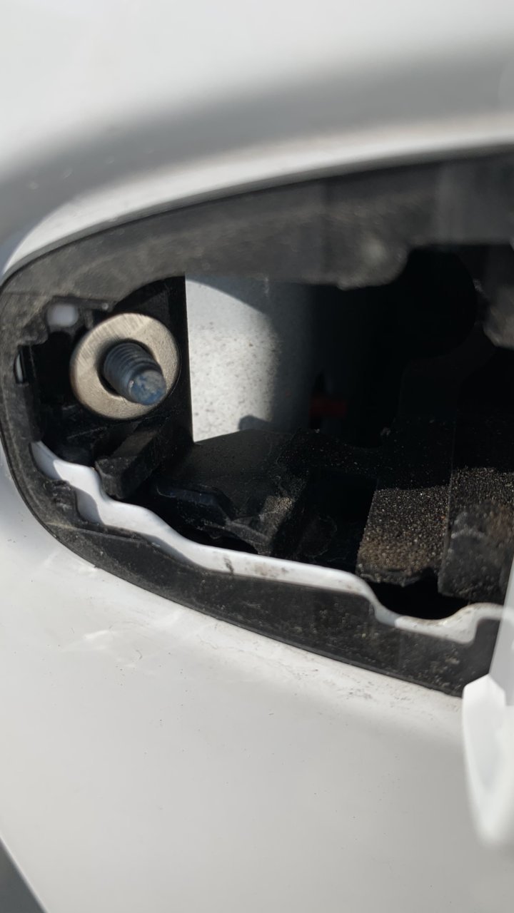

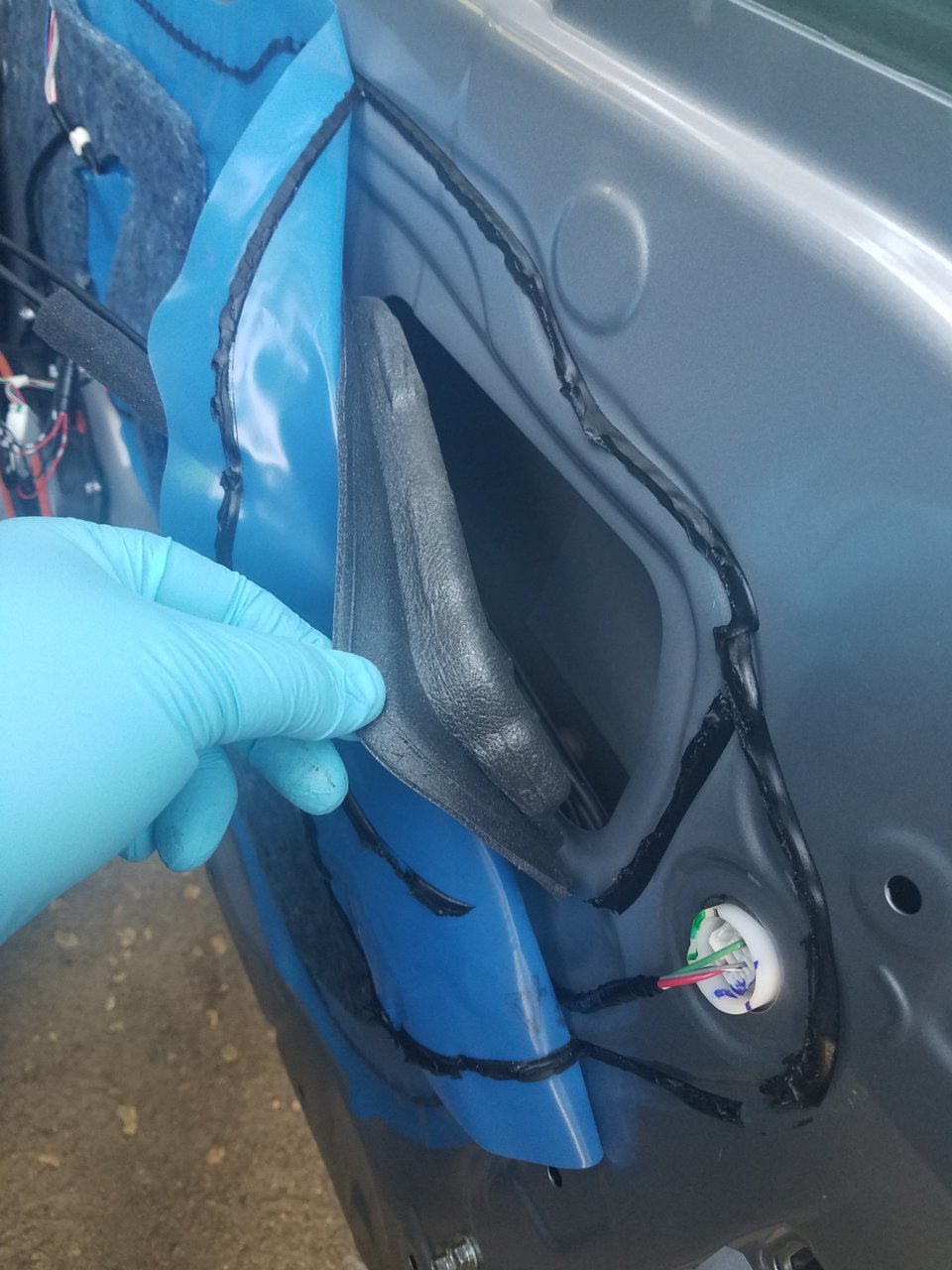

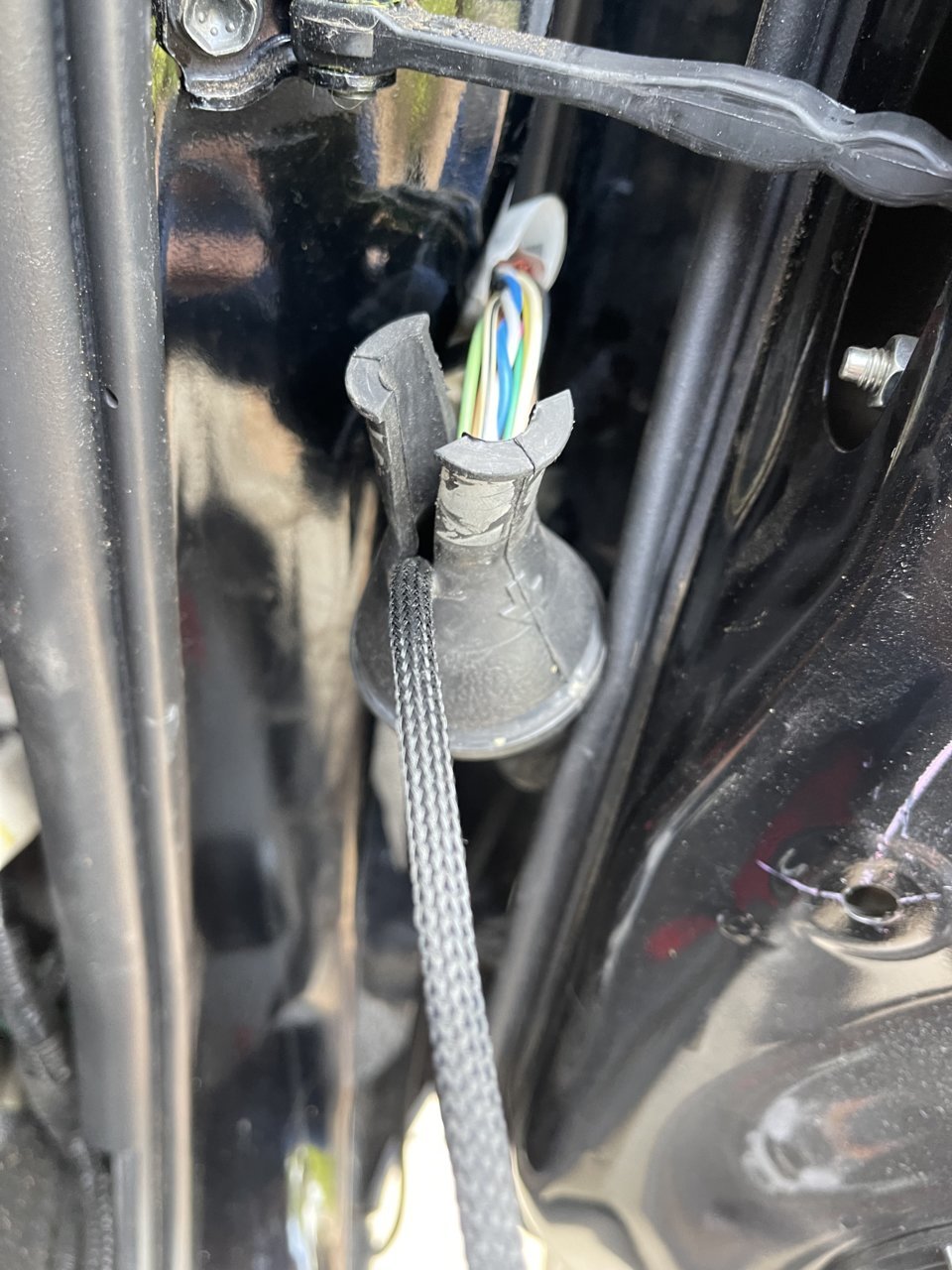

    Pulled the trigger after waiting a few years. I was hoping the price on the parts go down. And it did. Yes I struggled with the boots between the door and body like everyone else. But I noticed that the boot in my 2016 Tacoma on the body was sealed around the wiring. So instead I cut a slot on the inside of the boot to get the wires out. 1C7C832A-C370-45EA-BE0E-07EC04DFDEC4.jpg
    I also found that pushing the boot from the inside makes it easier to remove. This made it easier to pull the wires. Had to read through all the posting to find out if the wiring between the green and blue matter. Yes it does. If anyone missed it, the bottom wire on the door housing goes to the blue (to help remember, “bottom blue”). Top wire goes to the green. I use the posi-tap to tap the wires. It’s cleaner and small than T-taps. I also like the suggestion to put a washer on the T-30 screw. I used a small metal washer and it worked great. I had to watch on YouTube how to remove the door panel. The posting by Jessie Rizo’s “How to Install Front door speakers”. It was the best video.

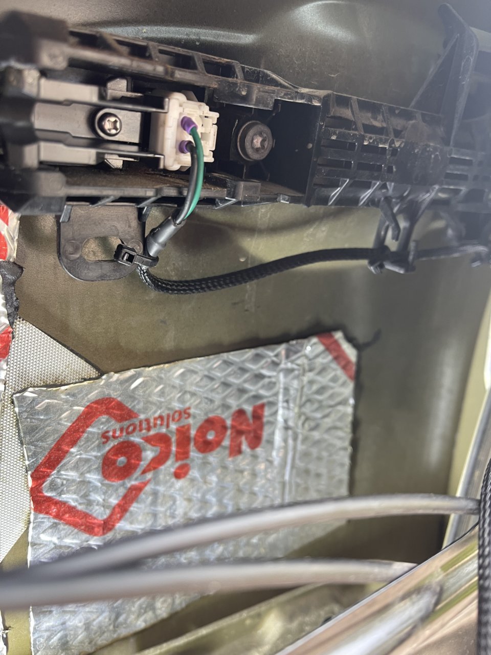

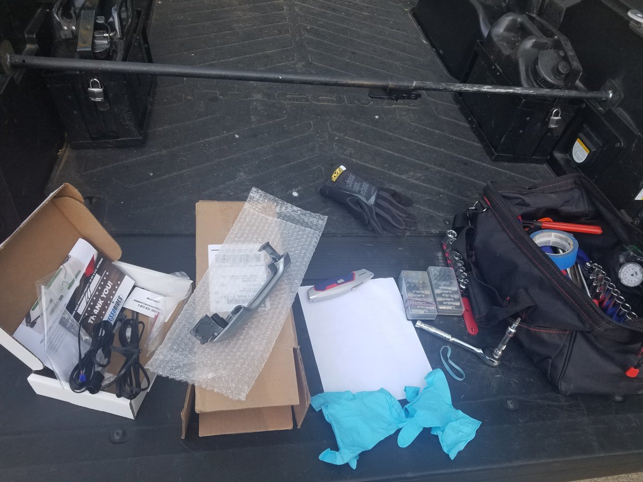

    I took time to install the passenger door smart key system on my 2019 DCLB with the harness from Accessorides. Super happy I did, because it's been bothering me every time I go to open the passenger door with the Lexus credit card key (seen programmed over here).
    Word of caution, the new door handle didn't go in without prying the greasy spring tab, in the 3rd picture, from the T-30 torx screw hole (handle doesn't work, handle spring broken, handle not working right).
    Parts:
    Goop:
    Greasy spring tab that needed to be pried down in place for the handle to go back in:
    Final product!
    Thanks to @Victory for the Lexus credit card key and this passenger door smart key mods! You rock!

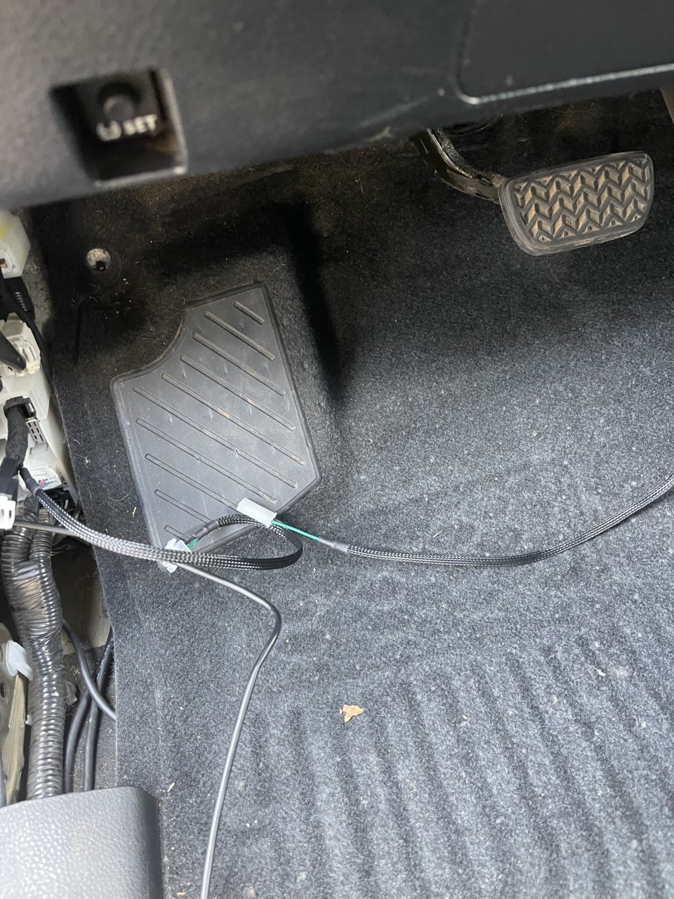

    Shout out to to @kmorgan3 for building me a bad ass no splice harness! And @caribe makaira for bein the invaluable caribe. Took about an hour to install. I Routed the wire to the right, around the track then through the door following the OEM wire routing. Pulling the boot all the way out is the way to go, including that white plastic piece. Just need to get my Lexus key card. Idk which one to buy though haha.

    I fucking suck at taking pics lol. There's a long harness w the handle connector at one end and a standard 2 pin connector on the other end. Then on the T harness there's a matching 2 pin connector.
