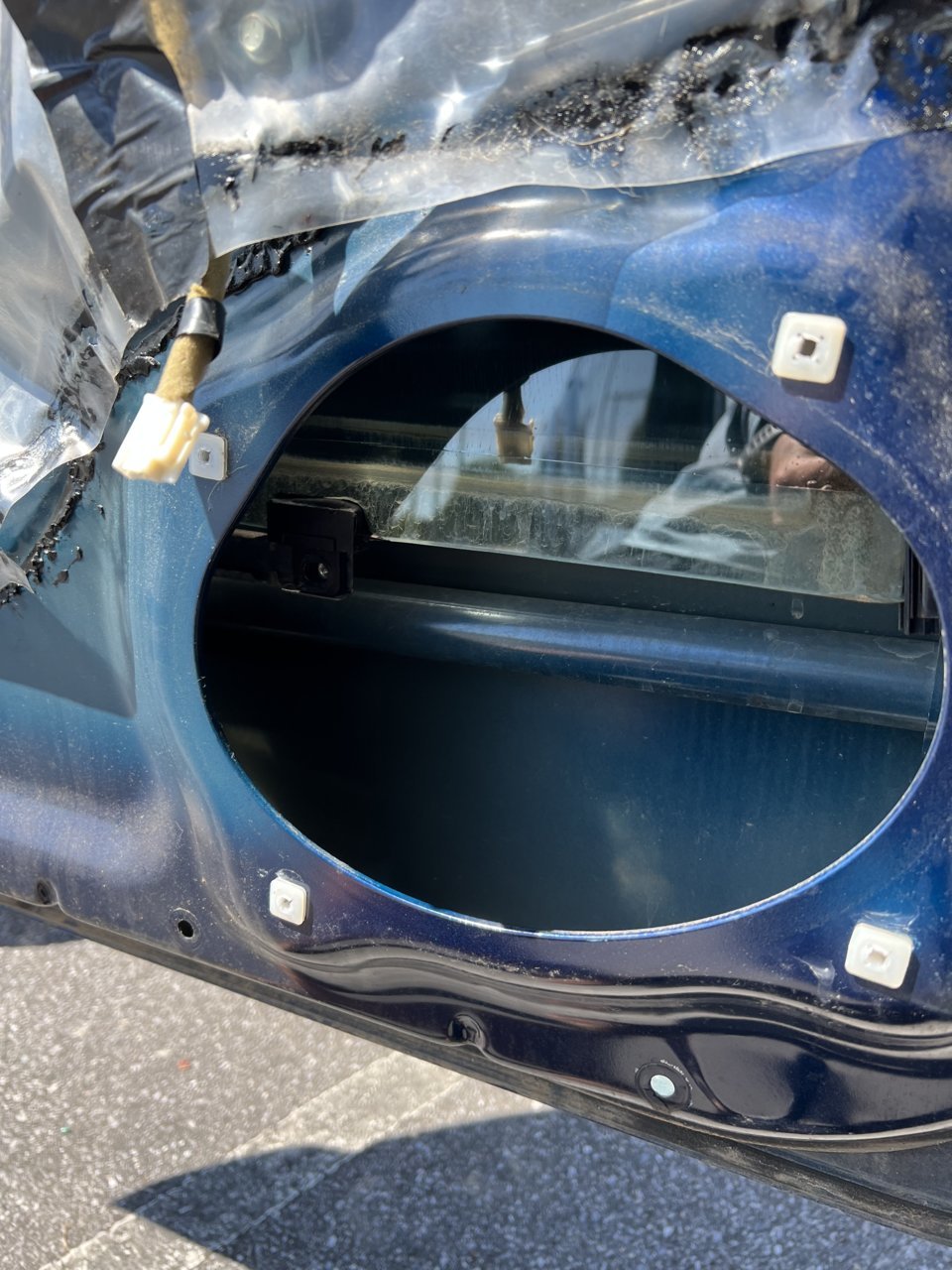

    I just did this repair so for anyone with a similar problem I uploaded a pic of the bolt that commonly falls off. Once you get the door panel off roll down the window and remove the speaker it should be right there. :)

  10. Sep 25, 2022 at 11:16 AM
    TnShooter
    TnShooter The TacomaWorld Stray
    Sep 2, 2010
    #42625
    17,523
    Deogee
    07' TRD Off-Road, Auto
    STOCK
    Thanks for the picture.
    This should be handy for the next guy:thumbsup:
