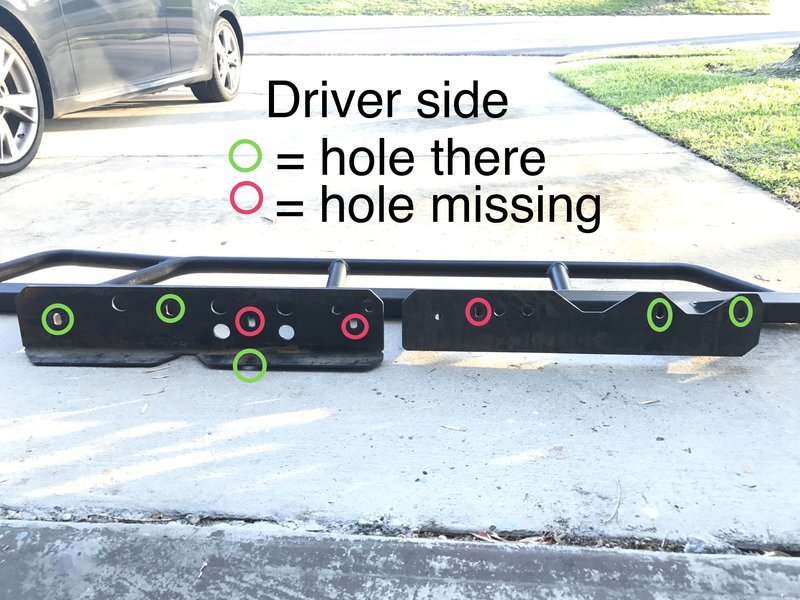

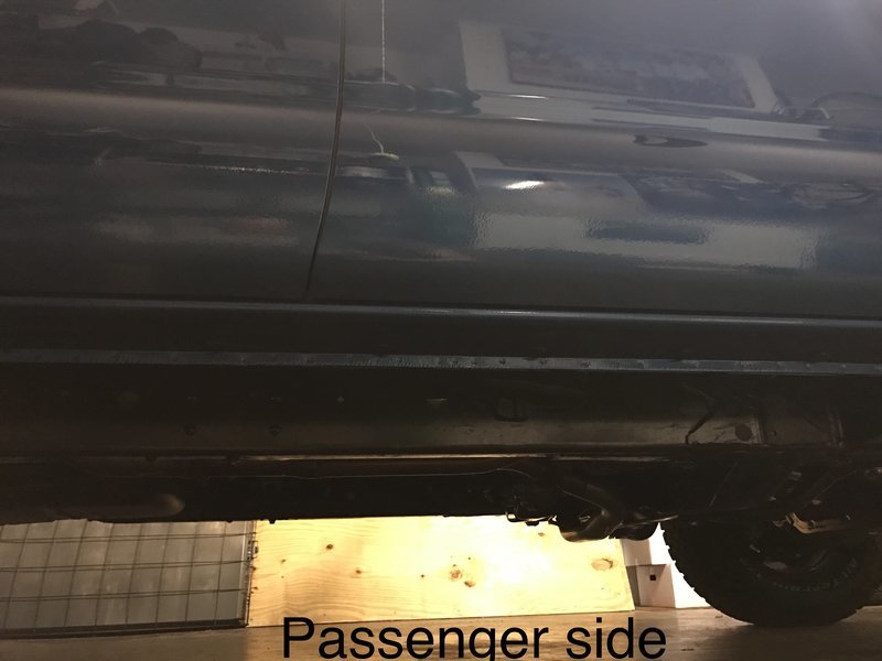

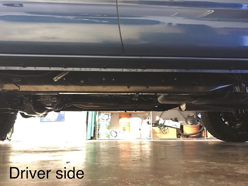

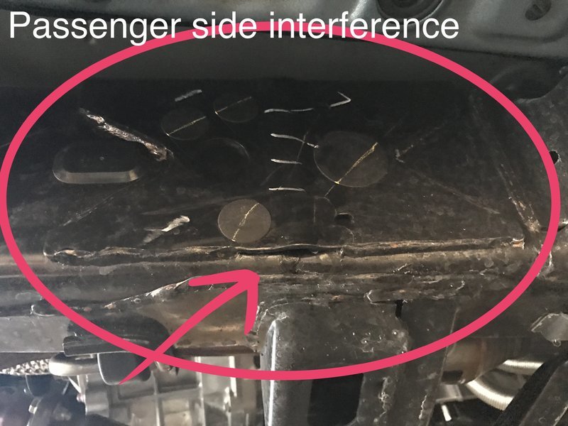

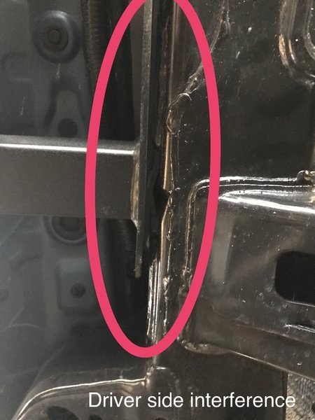

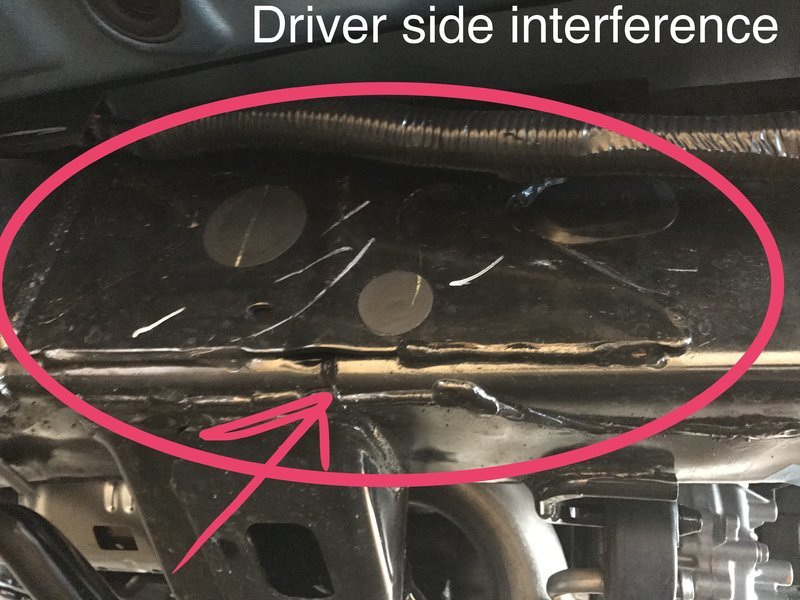

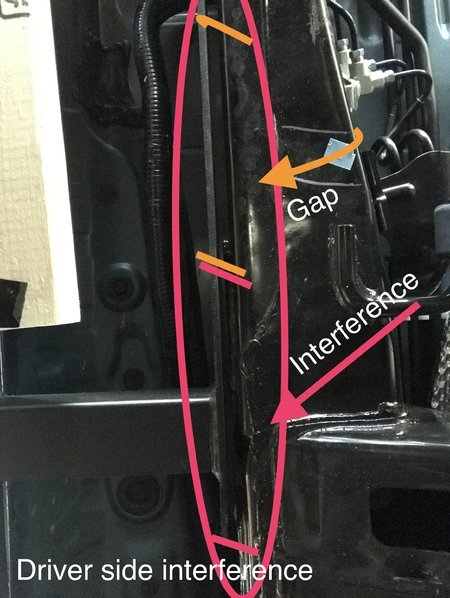

    SOS Offroad Concepts threads were deleted so my installation instructions were lost so I'm reposting them here
    I have a 2017 DCSB Sport 4x4. I bought my SOS Offroad Concept from another user with a 2016 DCSB Sport 4x4 who had no problems.
    I previously had two issues preventing me from completing the install. Note: Eddy at SOS Offroad Concepts helped me address both issues so I definitely appreciate his customer service!
    1. Welded plates with round protrusion on both sides of the frame towards the front causing a 1/2" gap or so for the front plate of the slider. I verified that the 2016 had a version of these plates as well but we're not sure if he had the same gaps after install.
    2. Out of the 7 slots for new bolts on the sliders, both sides of the truck are missing the 3 middle holes. The slots are in the slider but there are no holes in the frames in those spots. They are supposed to be pure bolt-in with no drilling required. I verified that the 2016 had these missing holes in their frame and it's just my 2017 that doesn't have them.
    See below for some photos to help explain the issues.
    And here they are installed with issues resolved!
    I initially had two issues with my initial installation but they have been resolved:
    1. Issue: Late 2016s and 2017s are missing frame holes
      • Solution: Use 3/8" holes on the frame including getting creative and repurposing some holes on the driver side, they're not in the ideal locations in all cases but I think it should be okay (more info below)
    2. Issue: 3rd gens have a bulge in the front of the frame on both sides that cause the slider bracket to not sit flush
      • Solution: Eddy made some spacer/shim plates that fit on each side of the bulge and I used a breaker bar to tighten all of the bolts insanely tight which helped bend the slider brackets some to sit as tight as possible against the frame, there's still a slight gap but I'm not too worried (more info below)

      3. For the inside:
        1. Remove the 1x 12mm bolt for the brake lines in the front of the frame
        2. Remove the 2x front plastic brake clips completely (will reuse these holes for the slider)
        3. For the black box, bend the lower right screw mount 90deg or remove completely (will reuse this hole for the slider)
      4. Jack up the slider using the 2x6 and secure with jack stands
      5. Install the following bolts (#'s correlate to pictures) and keep everything very loose until you get all the bolts in
        1. #1 (use shim plate, also use magnetic tool to hold the flange nut inside the frame while you thread in the bolt from the outside - this is the most difficult part of the slider installation)
          • Outside frame: 1/2x1-1/2 bolt, 1/2 washer, 5/8 washer
          • Inside frame: 1/2 flange lock nut
        2. #2 (use shim plate)
        3. #3
          • Outside frame: 3/8 nut, 3/8 washer, 1/2 washer
          • Inside frame: 3/8x1-1/4 bolt, 3/8 washer, 1/2 grommet
        4. #4
        5. #5
        6. #6
          • Outside frame: 14mm stock bolt
          • Inside frame: none
        7. #7
          • Outside frame: 1/2 nut, 1/2 washer, 5/8 washer
          • Inside frame: 1/2x1-1/4 bolt, 1/2 washer, 3/4 grommet
        8. #8
      6. Remove jack and jack stands and then tighten all the bolts down
      7. Cut 3/4 grommet into 6x 1/2in pieces, add two grommet pieces to each side of the brake lines where they go over the perpendicular frame support and then add a ziptie to each side, add two grommet pieces between the brake lines themselves to the left of the black box, add a ziptie to the brake lines to the right of the black box
      8. Push back plastic brake clip back through, reinstall front brake line bolt, reinstall nut for black box, reinstall bolt for silver bracket, reinstall two plastic wire loom brackets and redo electrical tape to hold wire loom to brackets
    5. Passenger side installation
      1. Remove 5 covers from the front of the frame with a flathead screwdriver (won't use all)
      2. For the outside of the frame:
        1. Remove the 1x 14mm bolt from the bottom of the frame (may need breaker bar)
        2. Remove 2x 10mm bolt from black box and remove cover
        3. Remove 2x 12mm bolt from bracket under black cover and pull up from frame
      3. Jack up the slider using the 2x6 and secure with jack stands
      4. Install the following bolts (#'s correlate to pictures) and keep everything very loose until you get all the bolts in
        1. #1 (use shim plate, much easier than driver side and no brake lines in the way)
        3. #3
          • Inside frame: 3/8x1-1/4 bolt, 3/8 washer, 1/2 washer
        4. #4
        5. #5
        6. #6
        7. #7
          • Inside frame: 1/2x1-1/2 bolt, 1/2 washer, 5/8 washer
        8. #8
        9. #9
          1. Outside frame: 1/2 nut, 1/2 washer
          2. Inside frame: 1/2x1-1/2 bolt, 1/2 washer, 5/8 washer
      5. Remove jack and jack stands and then tighten all the bolts down
      6. Reinstall bolts for bracket, reinstall bolts for bracket cover
