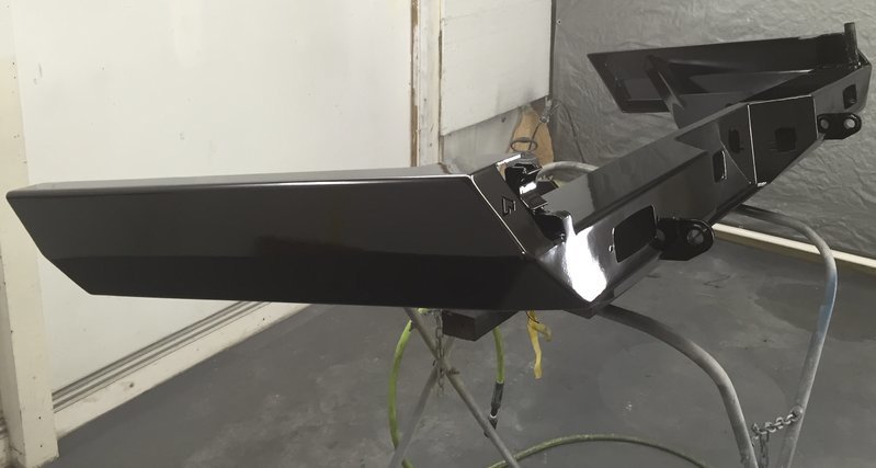

    Paint complete, sprayed with PPG Hot Rod Black. Currently looks like gloss black, but after it cures it'll flatten. Now to prep bed for cutting o_O
