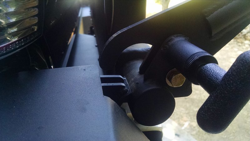

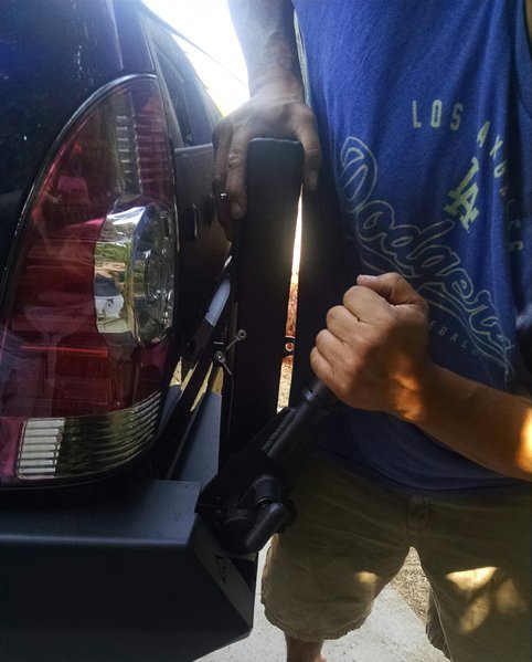

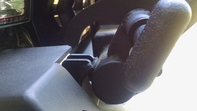

    Cool. I have huge channel Locks I was thinking of using with a rag wrapped around the cap to prevent the teeth from scratching the cap.

    Mine was like this originally, but once I put the spare tire on there, and drove around for a month, it has now settled and locks up just about right. Figured it just needed a little settling in.

    I used a pry bar and went around a little at a time.
