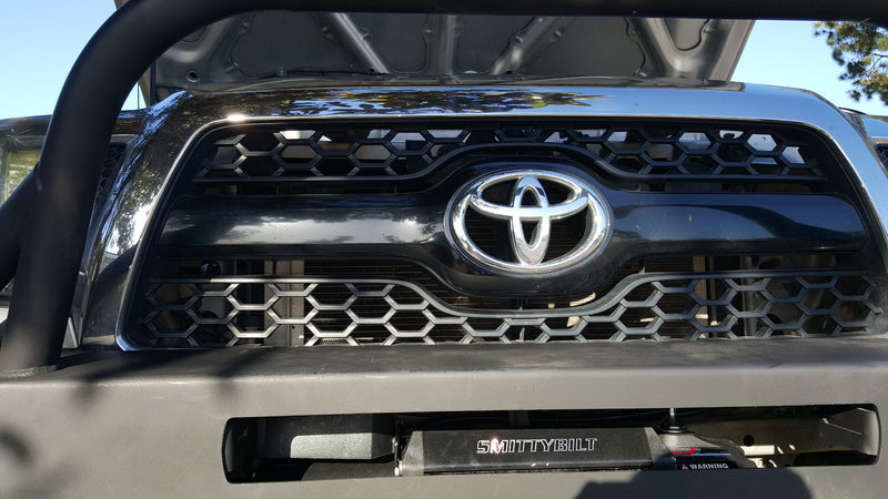

    Thanks Tyler, was awesome to see the shop and meeting you!
    Anyone have any pics of how they mounted the winch solenoid and where?
    I got a smittybilt xrc 9500. It's been a pain just mounting it and any kind of help would be appreciated 20160422_185743.jpg
    Wat3rdog likes this.
  10. Apr 23, 2016 at 8:08 AM
    #5350
    tomwil
    tomwil Well-Known Member
    May 15, 2014
    #129887
    8,025
    East Coast USA
    2014 Reg Cab 4x4
  11. Apr 23, 2016 at 6:34 PM
    #5351
    SuazoYota
    SuazoYota Well-Known Member
    Dec 29, 2012
    #93944
    352
    Spencer
    Southbay SD
    11 AC TRDOR 4X4 6SPD
    Not enough

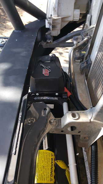

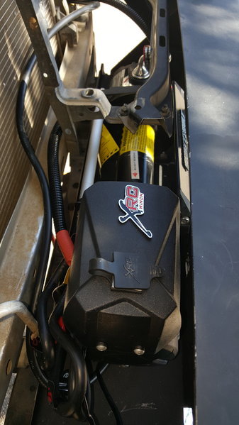

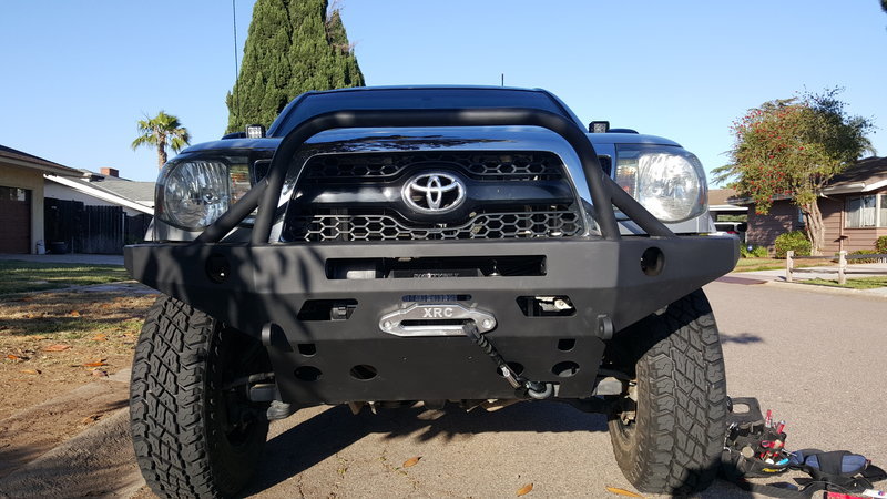

    Figured out where and how to mount the solenoid.
    Here's how I installed the smittybilt winch control box for anyone else in the future that struggled like I did.
    I cut that cross brace for the solenoid to clear, it still braces the center support and the passenger side isn't flimsy
    Also had to notch the grill for the plug in, hardly noticeable and works great
    Hope this helps, if I would of seen something like this I would of saved at least an hour or so worth of scratching my head and overthinking.
