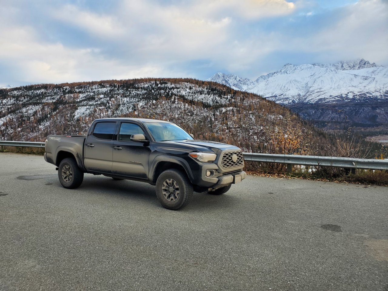

    3 days old and 2000 miles added to the odometer.

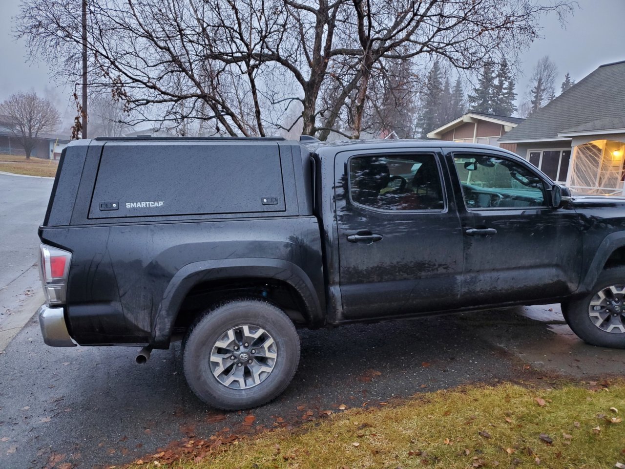

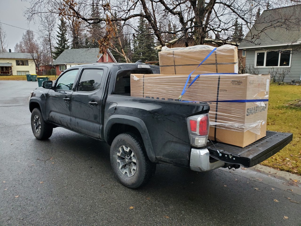

    Bringing home the RSI smart cap.
    Cap installed

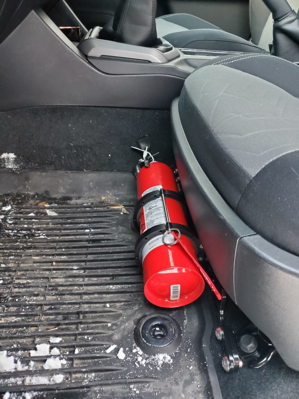

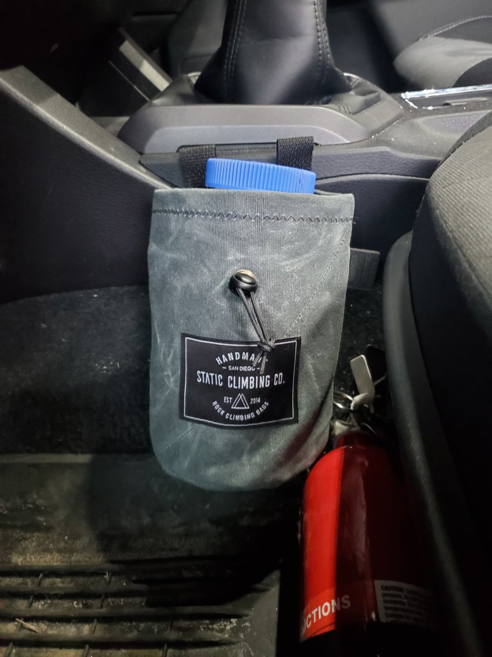

    Fire extinguisher mount.

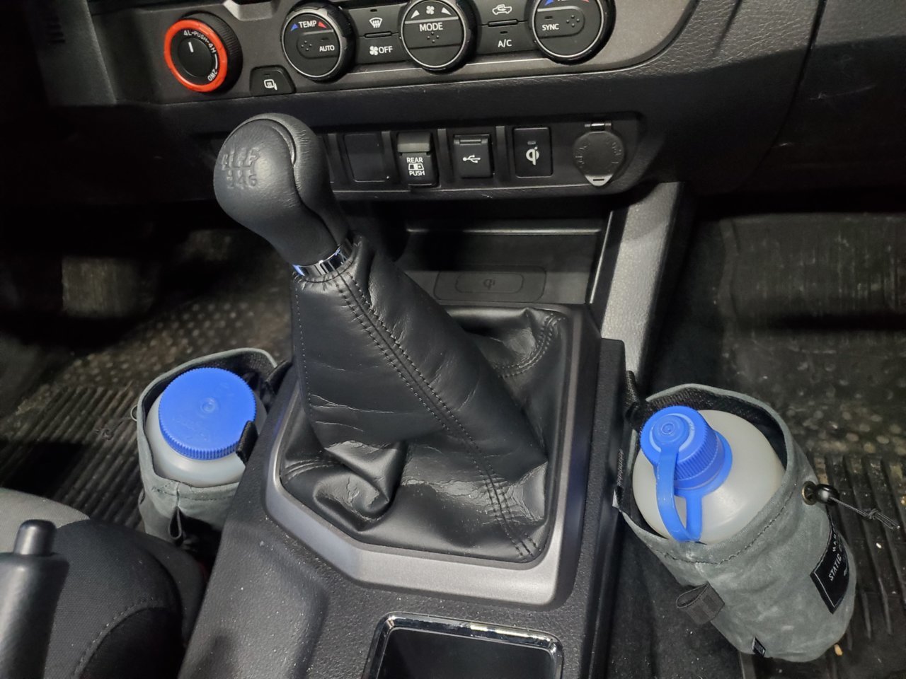

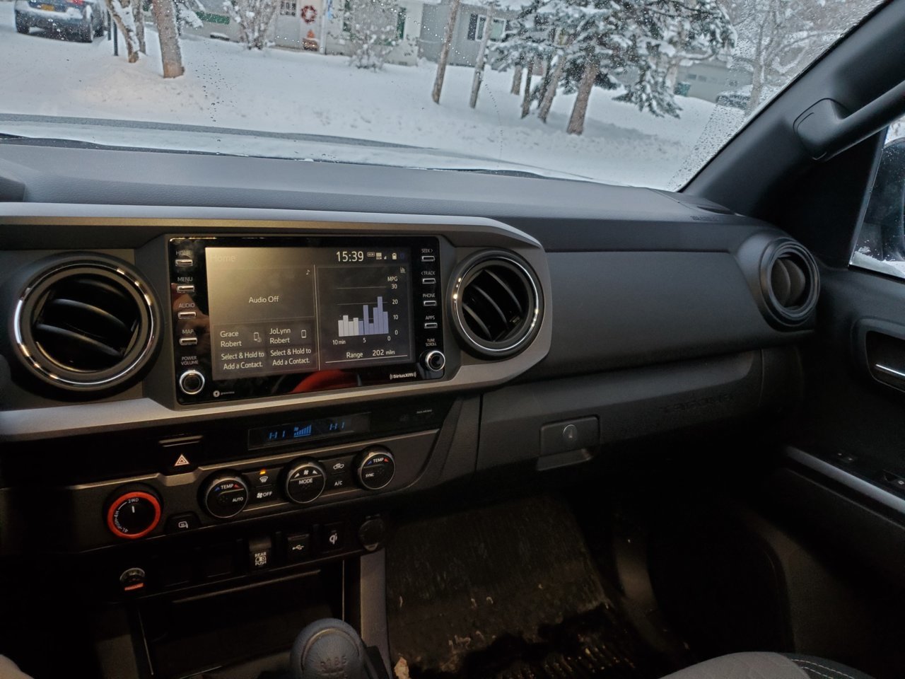

    And my unmatched chrome removal to irritate other people's OCD.
    The outer two chrome vent rings would cast a reflection on the side windows that was visually centered in the sideview mirror and they had to go. I may replace the center vent ring, but left them for now.
    I wanted the 4x4 knob to pop out more, so it got the red ring. This will most likely be the only bright color I add to the truck.

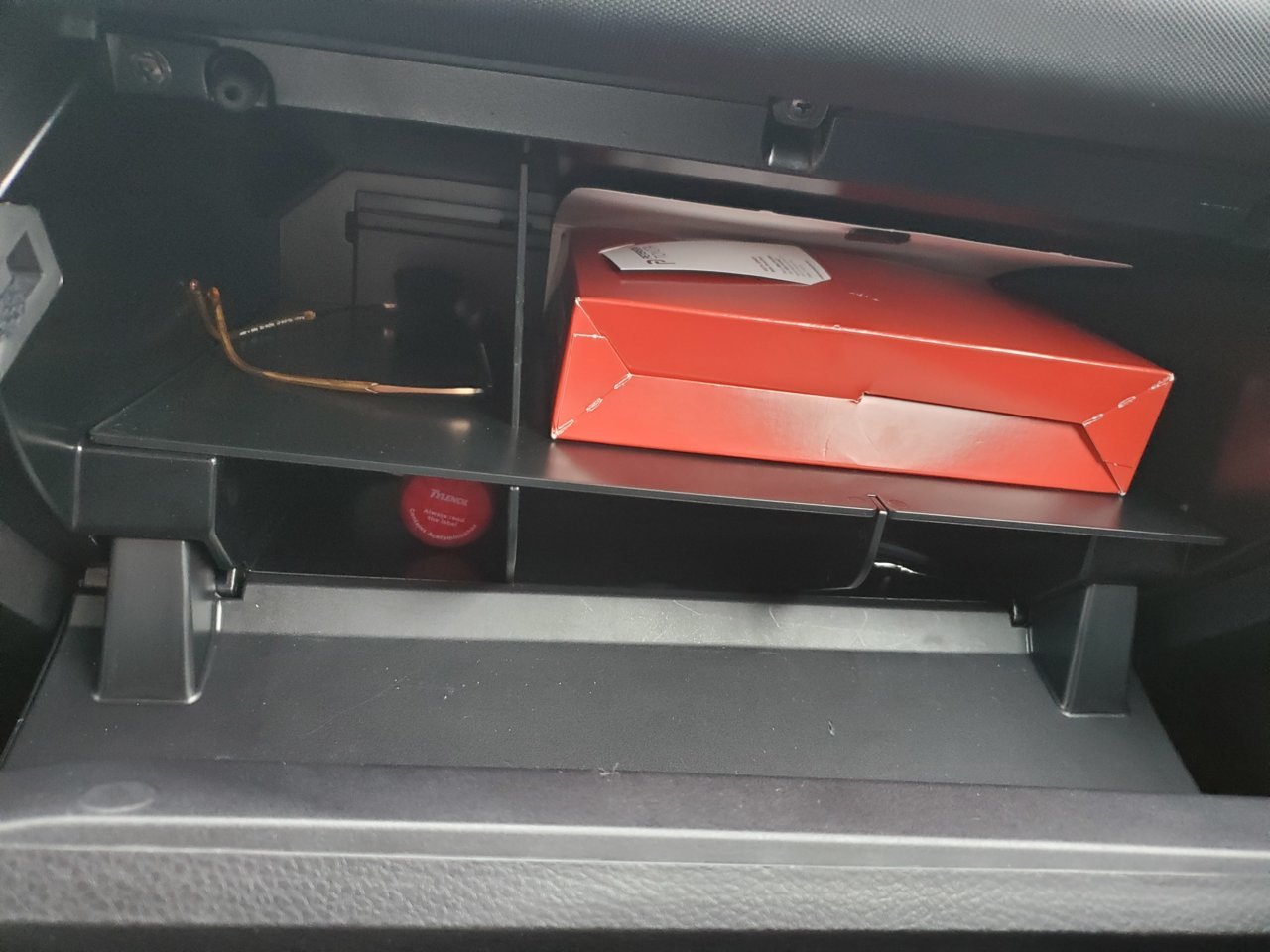

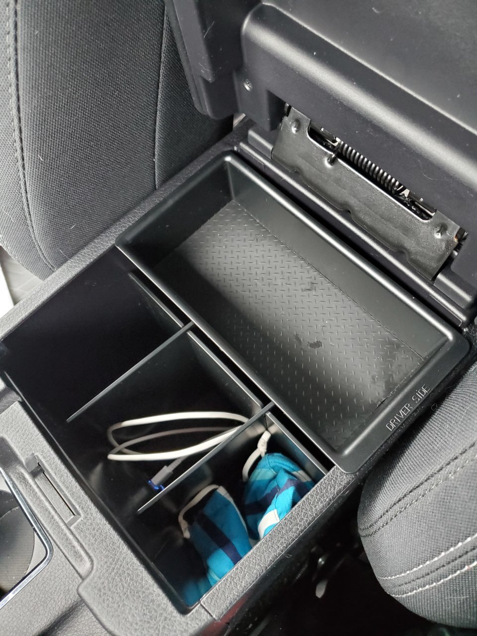

    These arrived today. Now to find time to install them.
    Glovebox organizer
    Center console organizer

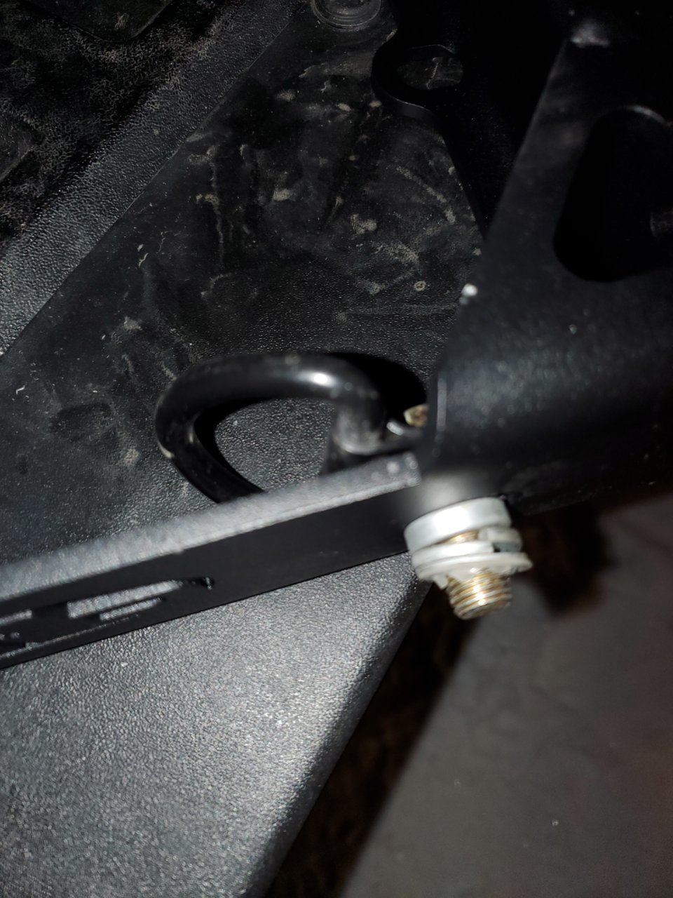

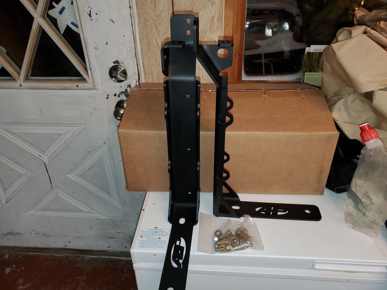

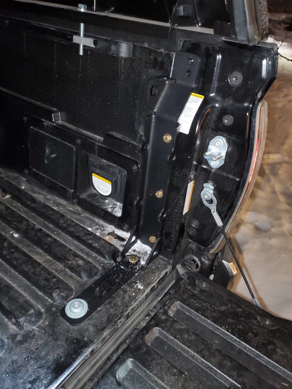

    These came in today.

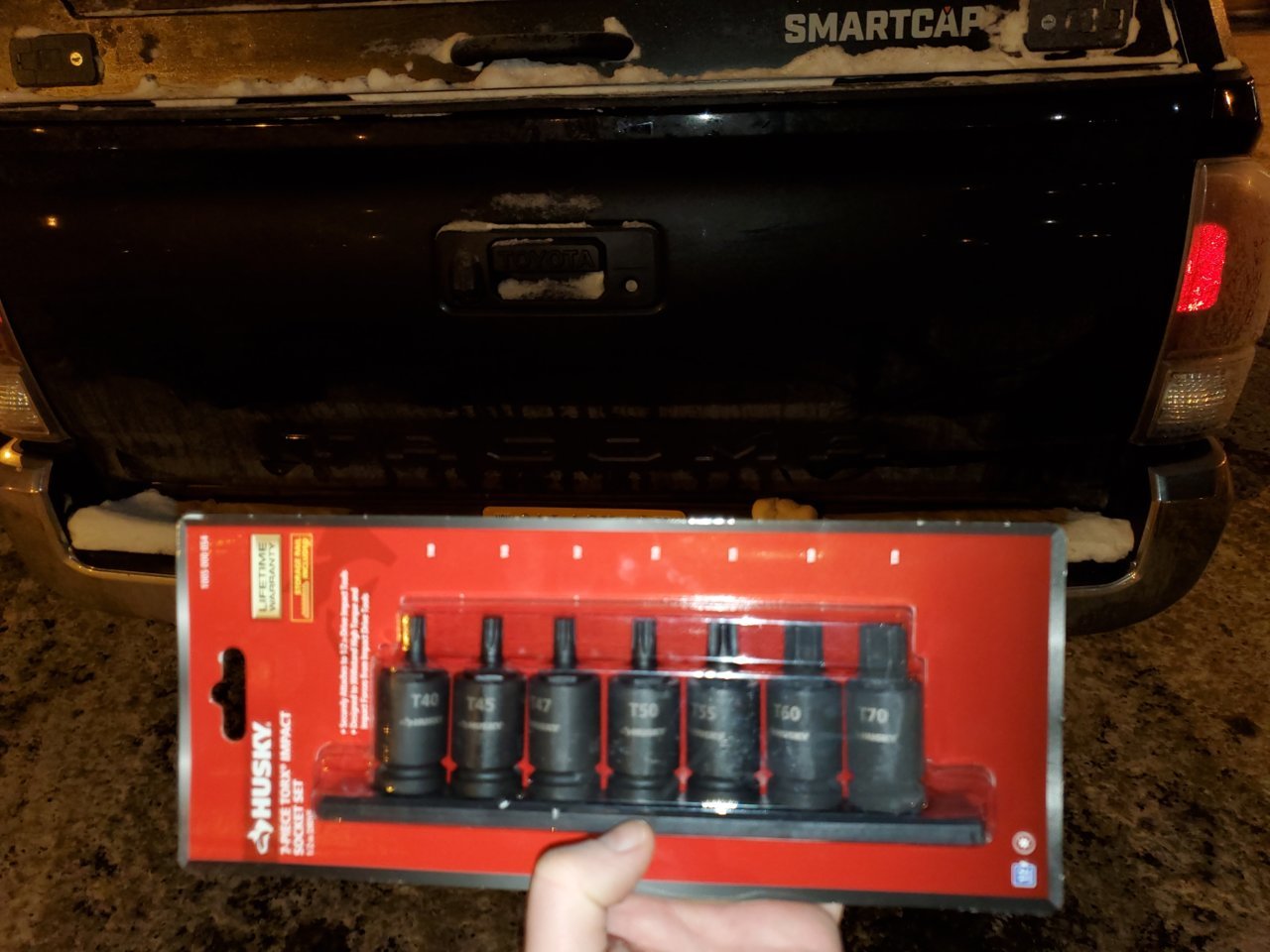

    I realized my torques bits only go up to T45, so I headed to the store.
    Found it was easier to put the hardware on the bolt rather than try to drop it in and line everything up.20211213_180053.jpg
    Finished up.

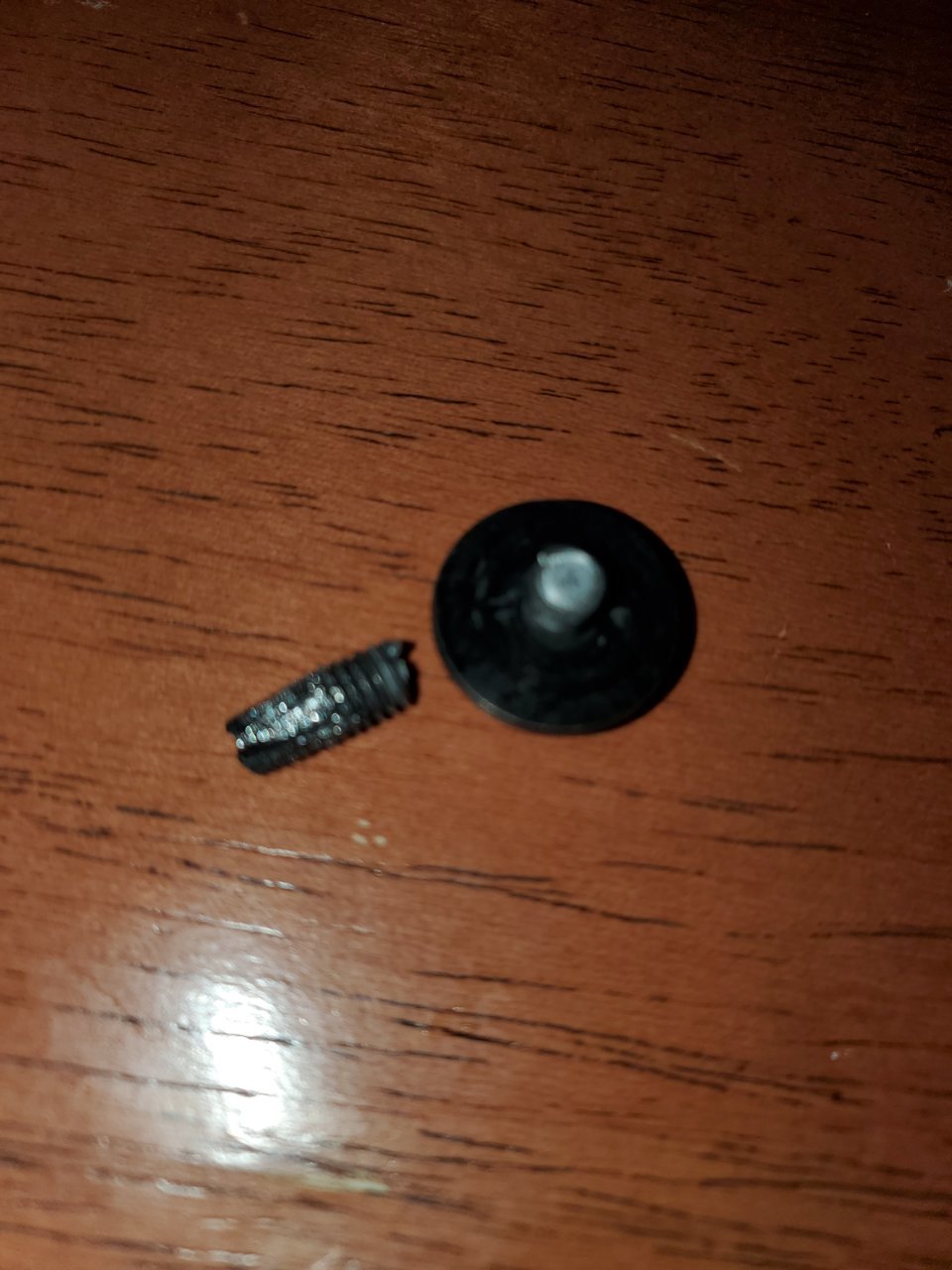

    But not without a reminder of what a dumb ape I am. I really need to get a torque wrent to bridge the gap between 135 in lbs and 40 ft lbs.

    That fire extinguisher mounts is interesting. Do you never notice it by your feet?

    Not in a way that matters. On long drives I will move my left foot up against the seat for a change of position, however I have enough space to still do this. I would say I know it is there, but I don't really notice it. In the past week I have driven about 18 hours and never found it to be annoying.
    Now for oversharing, feel free to skip. :argue:
    I will say that if I was much shorter it would be an issue as the seat movement is limited by the large quick drop fire extinguisher mount. I think the small mount would clear (but I'm guessing). Lucky for me, my wife is not short (I'm 5'10" for reference).
    One could always mount it behind the driver's or passenger's seat (I think this would be very annoying for anyone ridding in the back), or in front of the passenger's seat. My primary reason for putting it in front of the drivers seat is that I sometime put things in the other locations that would impede access to the extinguisher.
    The nozzle is pushed up against the transmission hump and decently protected from abuse, though not completely. I faced it down for two reasons, one is to keep dirt out of it, the other is to limit the horrific mess it would make if inadvertently set off (not sure how much it would help, and not going to test it to find out). One down side of dry chemical extinguishers is that the retardant is highly corrosive. I'm not aware of a good alternative that covers class A, B, and C fires though.

    I appreciate that write up! Thank you. And that is a good note about impeding access, I think I'd be in the same boat. Seems like a nice, no-nonsense place to put it and it is even easier to access than a lot of other places. I don't think there is a good alternative. At the end of the day, from my understanding, unless you are bringing a halogen extinguisher this is mostly to put out external fires, you are SOL for any vehicle fire

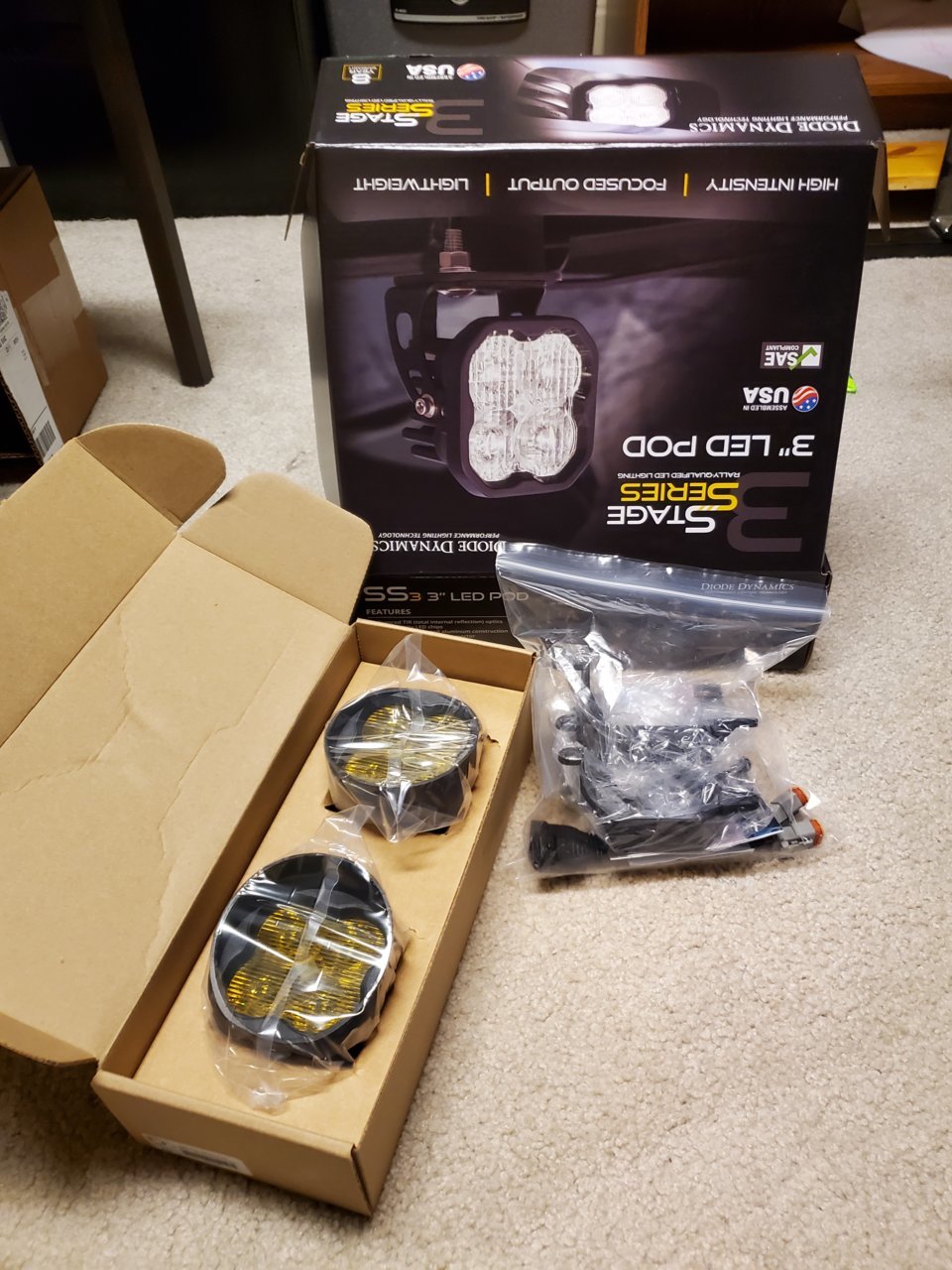

    On the DD SS3 Pro fogs. I find that for clear conditions they limit the range of my view. Too much light up close results in constructed pupils and inability to use the dim light coming back from further out. However, after driving several hours on the Denali Highway with moderate to heavy snow fall, they are worth their weight in gold.
    Of course this is not anything new, just confirming information that has been stated on various threads already.

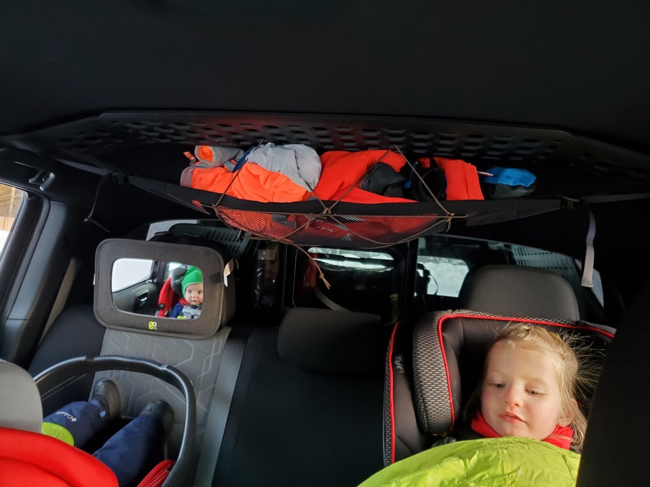

    Blue Ridge Overland Gear Tacoma Attic and Meso hexrack. The two work together nicely.

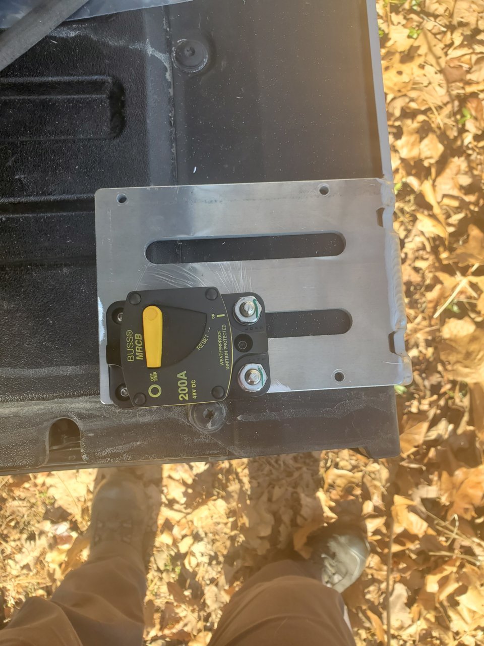

    Got the Off Grid Engineering battery tray prepped for the winch install. The breaker will also by my winch disconnect. Debating if I want to run a 12 inch cable around the side of the battery or a 21 inch cable under the batter to connect the breaker to the positive terminal.
    Planning on using a 1/0 AWG cable either way. The cables supplied with the winch ar 2 AWG, so figure any additional length should be larger than that.
