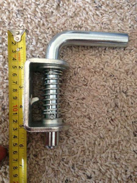

    I also received the beast of a pin I will use for spare tire carriers. Waiting on the spindle.

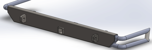

    Mainmoe, you're looking for a tube wrap around on the #2 bumper, correct? I can try to figure that out. I need to find a decent tube bender locally and it's been a struggle, so I try to avoid tube. I will investigate it further though.

    Yes, your 2nd bumper is one of my favorites out of all the 1st gen bumpers. But like I said, I have grown to like/ need the tube wrap around protection that some of the companies offer. If your 2x6 bumper had that option I would jump on that ASAP.

    I can do it. Might add about $125.
    I made a quick rough mock up before I go to class.

    Make it out of 3" x 6" and push it a hair more out from the truck. either way, i like the simplicity and how stout that bumper looks.

    I could probably do a 3 x 6 actually. I will get something drawn up.

    This with a tire carrier would be right up my alley.

    Straight forward 3" x 6" with tire carrier,D rings and receiver and you just might have a winner.
