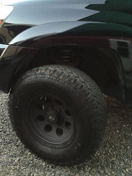

    Hey Guys,
    Heres my current build:
    -2011 Black Tacoma double-cab prerunner off-road model
    -Bilstein 5100's front and back
    -Toytec eibach coilovers
    -1 inch rear block
    -1.5 inch wheel spacers
    -16' Black Procomp alloy wheels with .5 offset and 4in of backspacing
    -285/75/16 General Grabber's

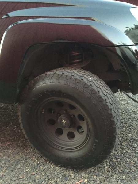

    Ever since the lift I have had two problems
    1. Ive been having problems with my VSC ever since the lift and I'm gonna solve it by doing the abs kill switch with Croms way:https://www.tacomaworld.com/threads/abs-kill-switch-mod-for-05-offroad-easy-way-pics.170927/ that should solve the problem
    2. My tires rub barely on the fender either when I'm in reverse and crank the wheel with people in truck or when I'm off-roading and I hit a bump with steering wheel cranked. Ive already trimmed the inside fender as much as it should be. My question is that its lifted 2.5 in the front and 1 in the back, how much more should I lift it to not rub or what can i do? (The front shocks are set at .85 with coil over adding 1.6)
    If I can get this out of the way, I can do all my other mods I want to do! :)

    Thank you for the welcome, tacoma world is so helpful! Well I got the wheels aligned and a point zero calibration and it helped a little but not much. I did get 4 wheel parts to to a Cab mount cut too!:( I wonder if I got it too stop rubbing in the back and more towards the front so i could get a whole new front bumber/grill guard to clear it. But i think in the end i either have to down size tire or lift it a little bit more since i have the bilstein adjustables. Im just trying to get the easiest/cheapest way to make it to not rub at all.

    Its only rubbing on the front mostly, but I think if I get the caster moved foward and a new front bumper/ grill guard it would not rub. What do you guys think? I think this could work because i dont wanna lift it more cause my mileage would go down hill haha.
