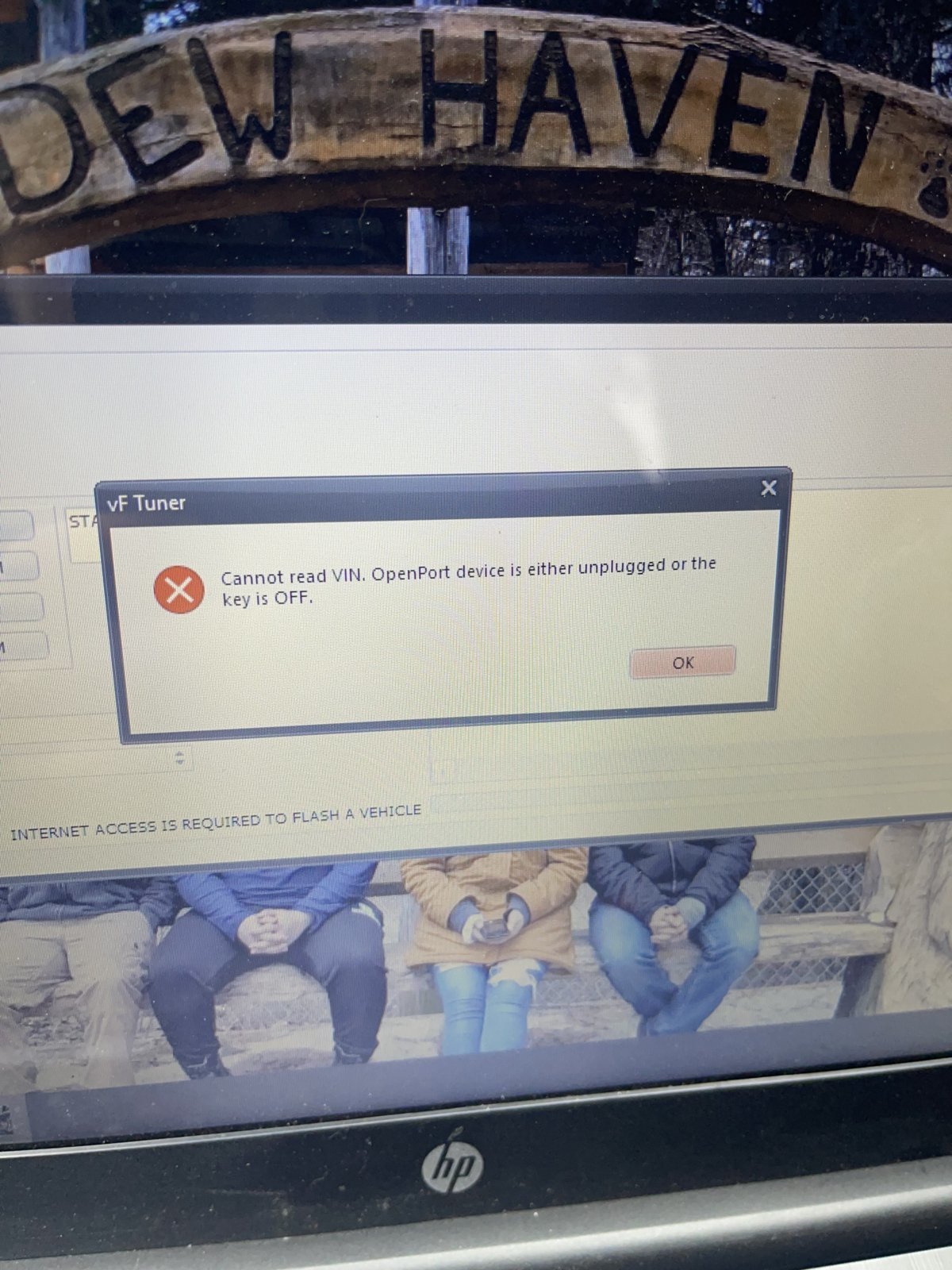

    I’m preparing to sell my truck soon and I decided to flash it back to stock. I selected the correct file (04B04 stock), the tuning went through OK and gave me the success confirmation. Immediately when I tried to turn over the truck it wouldn’t start. Now trying to connect to it again vftuner gives me this error. What do I do?

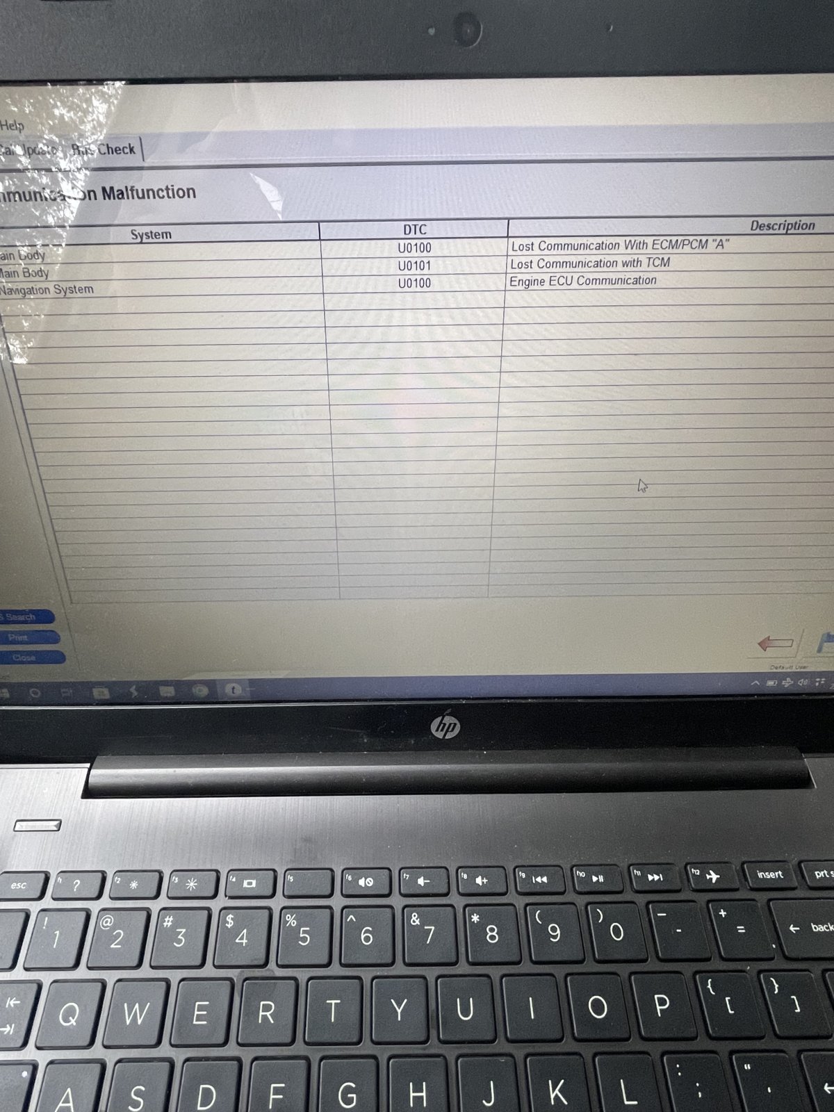

    I have this for communication malfunctions when I tried to diagnose in techstream

    Ecu is bricked. Need a cable to recover
    That stock file is no good. Reach out to your tuner.

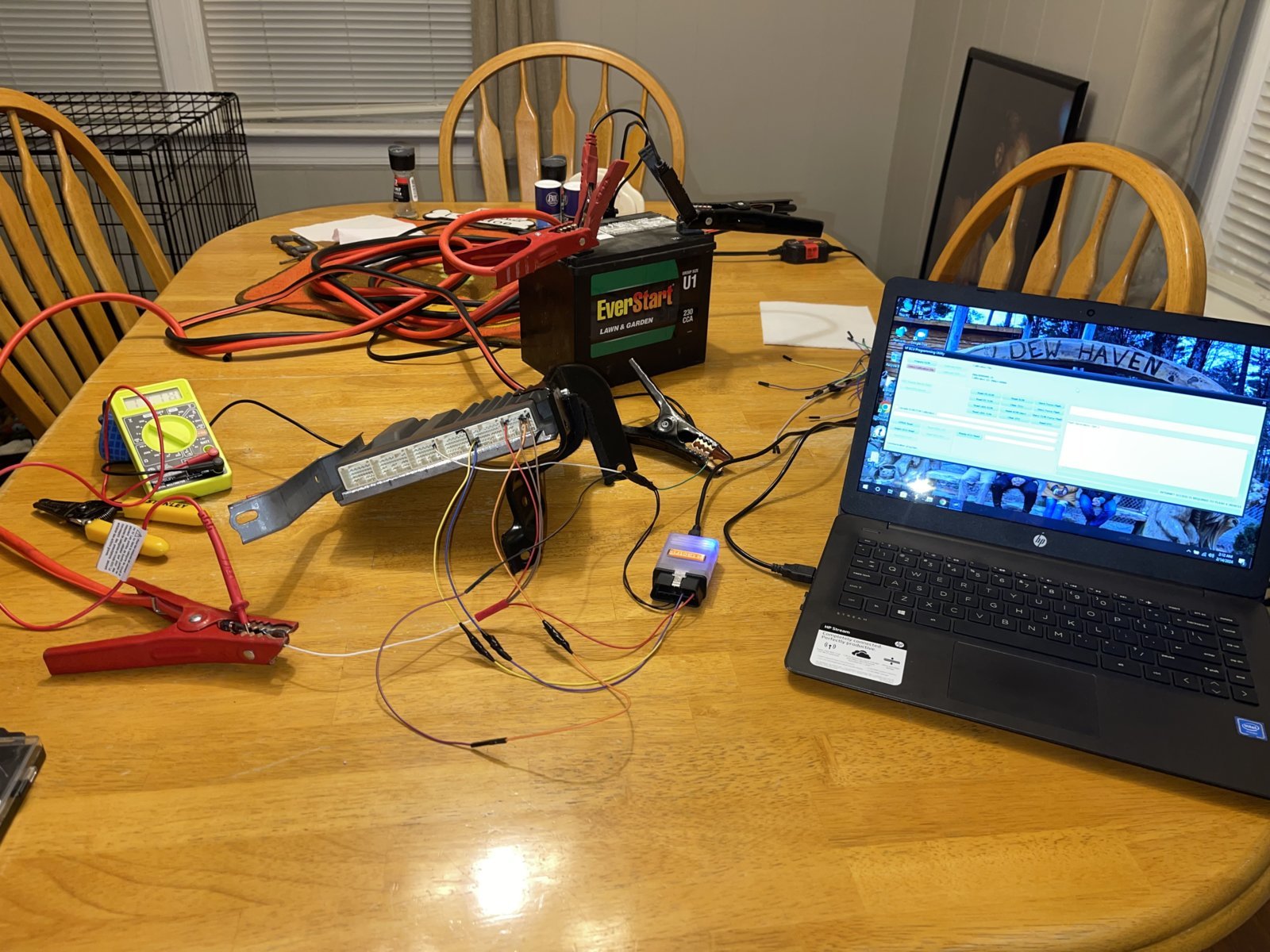

    Hopefully it'll work for you..but be prepared to yank the ECU out. The harness is actually quite easy to make if you have the right wire/pins I believe I linked in that thread.

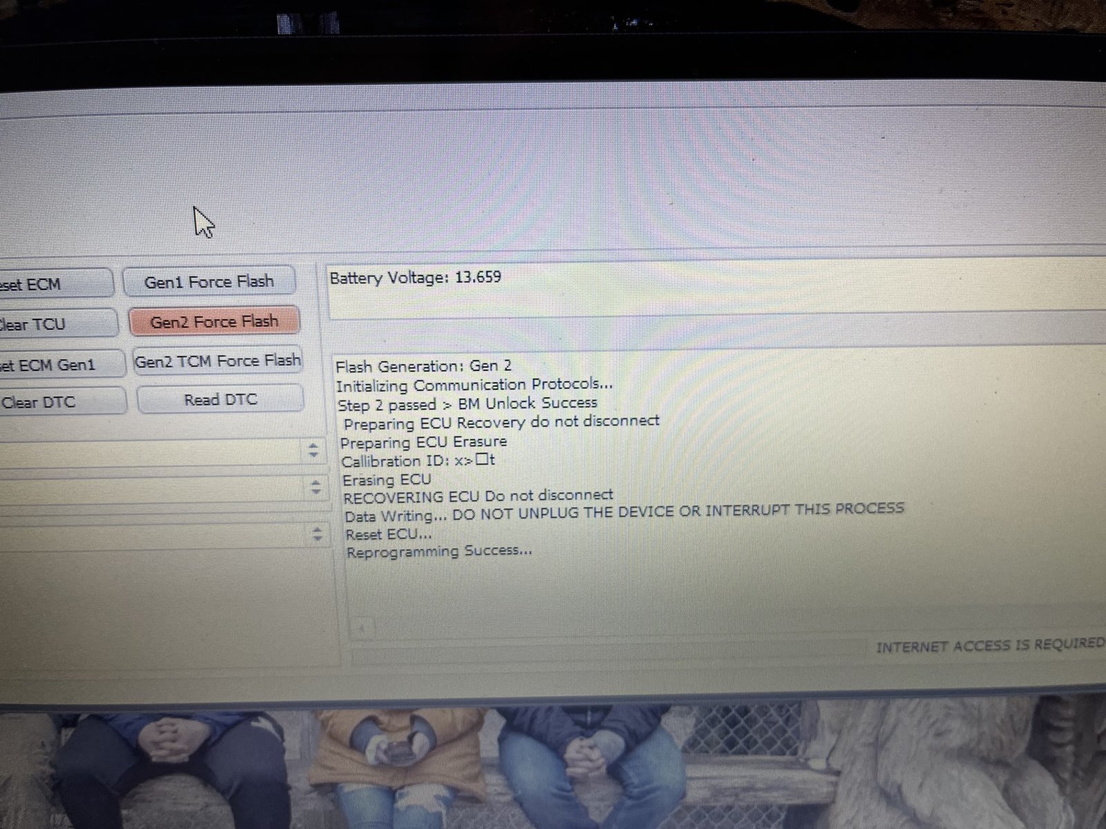

    Got the bench flash done successfully! Thank you guys for saving me! Feels good to be mobile again :mudding:IMG_0081.jpg IMG_0082.jpg
