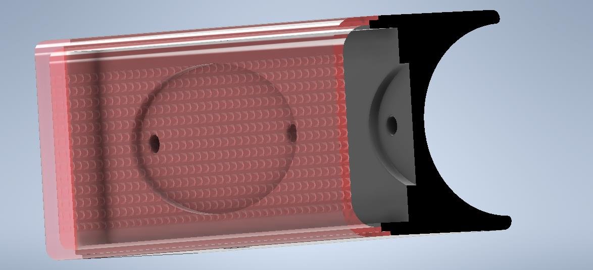

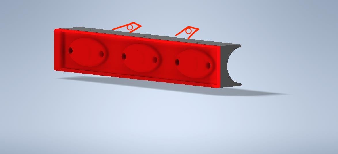

    alrighty.... When this thread started I had NO idea I needed a brake light tap, fast forward a bit and I realize that once I put the bed rack on and the RTT I would need to mount a brake light on the rear bed bar since the factory one is now blocked. So, I order one of the taps in anticipation of a new project. A custom 3rd brake light, yes I know you can buy one cheaper than what it will take to build the one. But designing and building my own custom brake light is a good excuse to expand my CAD skills, and to try out some resin casting.
    Yep this is the idea that spun up in my head as a direct result of this very thread.

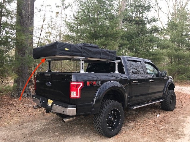

    I've got a custom idea for you based off this design. I've been looking for a 3rd brake light that has mounting holes in the back of it so that I can screw it (forever) to the underside of my RTT. Here's an example of the location:
    The holes in the back I'm talking about would serve the purpose of a right-angle bracket that attaches to the tent. On the wire-side we could make a water-proof connector to allow the harness to be removable. It'd be a very short wire run to the connector.

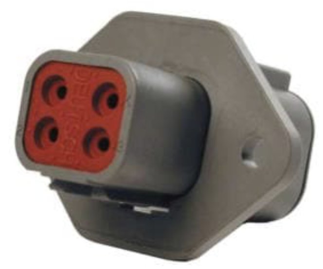

    Johnny's harness would be configured in this way: From Johnny's brake tap we would run the wires up to a flush-mounted connector in the bedside. Like a Deutsch:
    Then the wire harness portion would plug-in to the flush-mount connector in the bedside and then run to the brake light. It'd keep everything very removable.

    so your thinking of having a removable jumper from the light and the bedside connector? If the light is going on the underside of the RTT , guessing to the floor? would the screw not need to go through the top of the light?
    I like the idea of that flange Deutsch connector.. gonna have to work that into the bed. could also provide a nice delivery point to run 12vdc up into the tent through a floor mounted outlet of some sort

    Correct! It'd be thru-bolted through the floor (underneath the mattress; like the mounting rails). The bolt could go through the top of the light, but I imagined it would be easier to attach a bracket to the light and then use some new holes in the bracket to do the mounting. That way thru-bolting is easier. Here's a crappy photo:

    You're a step ahead of me with the 12V :thumbsup: You could easily make a tap from the trailer connector or elsewhere to give some power into 2 pins on the flush-plug. Then your wire harness would have two connectors on the other end: one to the brake light (from Johnny's tap) and one to a USB charger or something that goes into the tent.

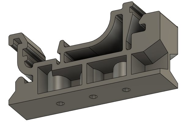

    in that case a molded in rail connector on the top .. think DIN rail style. would be good. screw a short piece of DIN rail down and then slide the light onto that and lock it into place

    something like this on top
    the 3 holes could get a a heat set thread insert either in the light top or the mounting "foot"

    I have been prototyping something like this with the deutsch connector. This one has turn signals, brake, parking, reverse, ground, and a constant to be ran back to the battery.
    https://www.tacomaworld.com/threads/puppypunters-idea-hole.711584/page-13#post-25655184 The deutsch come in 2 (though not black, but I have a guy with a 3D printer solving that hopefully), 3, 4, 6, 8, and even a 12. I was planning on kind of do these as a built-to-order kind of thing. They can do everything listed above, as well as:
    -lock/unlock (if you have tailgate lock installed and want to add a pop & lock for a topper)
    -bed light tap for a cargo lamp to come on and off with the bed lights. Can do a plug and play solution for 16-19 with the bad lights added, or a 20+ with or without the bed lights. Soppyse I could do it without the OEM option if the user wanted to run the wires and tap the bed light signal.
    Could also use the battery tap for really anything (like an RTT) up to about 7A. (Limited by wire gauge really. Can arrange for more power to be ran, but deutsch size 16 will only accept 14ga wire in a solid type, 13A per connector. So you can get creative with a larger gauge and a bus bar or something).
