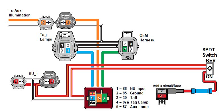

    Assemble it yourself...

    Clean. But no output in reverse without parking lights on. Likely a non-issue though?

    Switch would do the juice.
    It's the "I want everything in one" that kills it. Like the dimming feature some can't live without...:rofl:

    But you drew it with 30 coming from parking light and 86 from the switch :)
    I do like the version you posted though, it's clean, it's simple, much like the DIR I did for you w aux output, minimal extra stuff.

    OP wanted the tag lights OFF...
    And no need for BU illumination if not dark outside...(parking lights ON)

    Yes, which is the beauty of your posted solution, combo DIR and aux reverse lighting.
    To make it a fully independent circuit for the aux reverse output would require more than one relay as I see it, and make things even more complicated for minimal net gain.

    I was figuring a second relay to run the dd light by itself so it doesn’t overload the factory backup lamp circuit.

    Unnecessary. OEM wiring has plenty enough headroom for a single C1.

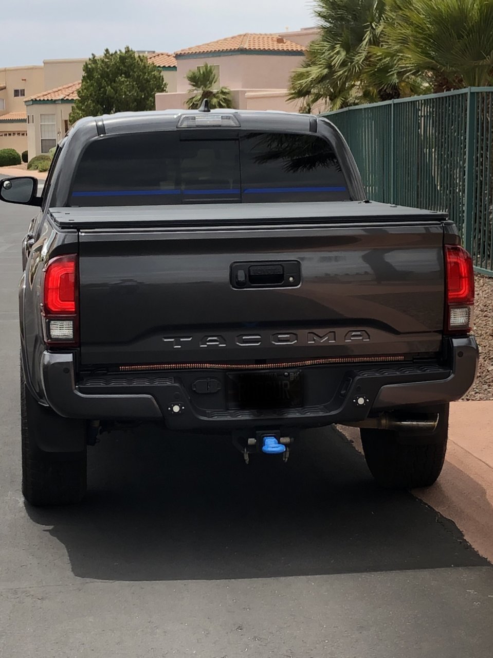

    Totally forgot about this thread, this is what I ended up withB78B92EF-58C2-43CA-8D72-AF06505EB8CA.jpg

    Looks good. How does it work? How'd you wire it?
