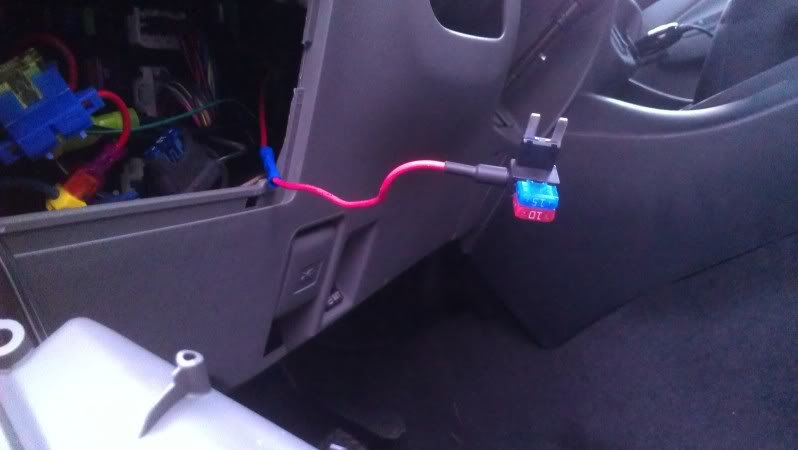

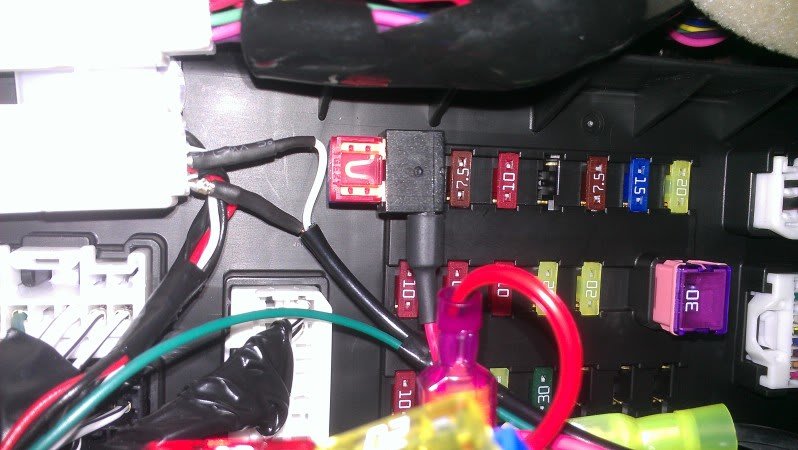

    So I installed my gauges (dm-6, dm-100, obd II module, A/F module, Boost module), completely, only to find that mine were DOA. I'll do a real write up when I re-install this weekend. Here's the quick version.
    I ran my modules under the driver's seat. The reason is that the only wires that went through my firewall and into the engine bay were the wideband sensor and 1/8" vacuum line. I pulled power from all 3 modules by using an add-a-circuit on the 15 amp ignition circuit. I put a 15 amp fuse on the new circuit since I was running 3 modules (5 amps each). I ran the power wires through the center console and under the seat. My ground was done under the seat as well. I ran my grey wire on my A/F (the narrow-band feed) to the ecu through the center console, under the passenger side carpet, and down the passenger trim to splice into the ECU. If you need the pinout for the 2012, let me know and I'll get it to you. I'll post up once I do my real write up.

    Pic please of your add a circut config

    See pics:
    View at the fuse box, notice the add a circuit in the top left
    Add a circuit removed.
    The grey wire gives a narrowband feed from the new sensor to the ECU, which means the ECU still functions like normal, no check engine codes or strange running conditions.

    Thanks for the pics. Quick question...did you just splice all three power wires onto the add a circuit without individual 5 amp fuses?

    Yes, I spliced the three together without individual fuses, probably not the most correct way to do it, but 3 separate fuse holders would be a pain in the ass.
    I read somewhere that you could power up to 3 modules off the same power source. Just an FYI.
