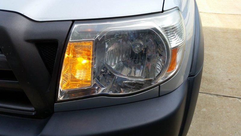

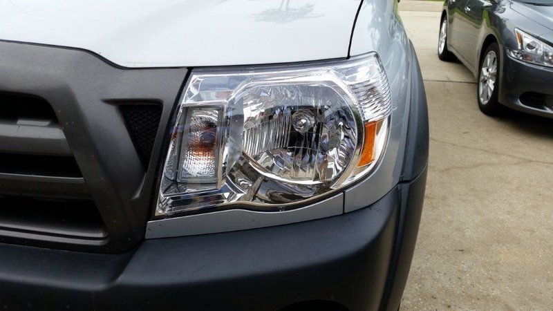

    Since they changed mine the DRL section of lens is no longer amber colored, but now the lens is clear and the bulb itself is amber. Is that what you mean? I'm not sure what "original to the OR" means?
    Old headlight:
    New headlight:

    My original lights on my Off Road have a smoked lens. Dealer mistakenly installed clear.

    This is the end of my story with the DTRL. Dealership installed the correct, new design, smoked, headlight assemblies (both) under the extended warranty.

    The new design headlight assemblies have a clear glass lens in front of the DTRL where the old had yellow plastic. I am happy with the look and don't feel like LEDs are necessary to prevent melting now.

    i got the same replacements last week. I actually liked the clear lens better.

    The DTRL lens is clear. See DES2009s pics. Good example of before and after.

    The new light assemblies are absolutely gorgeous and aren't super star wars if that is what you are concerned about. Just a minor change in the orange light area.
