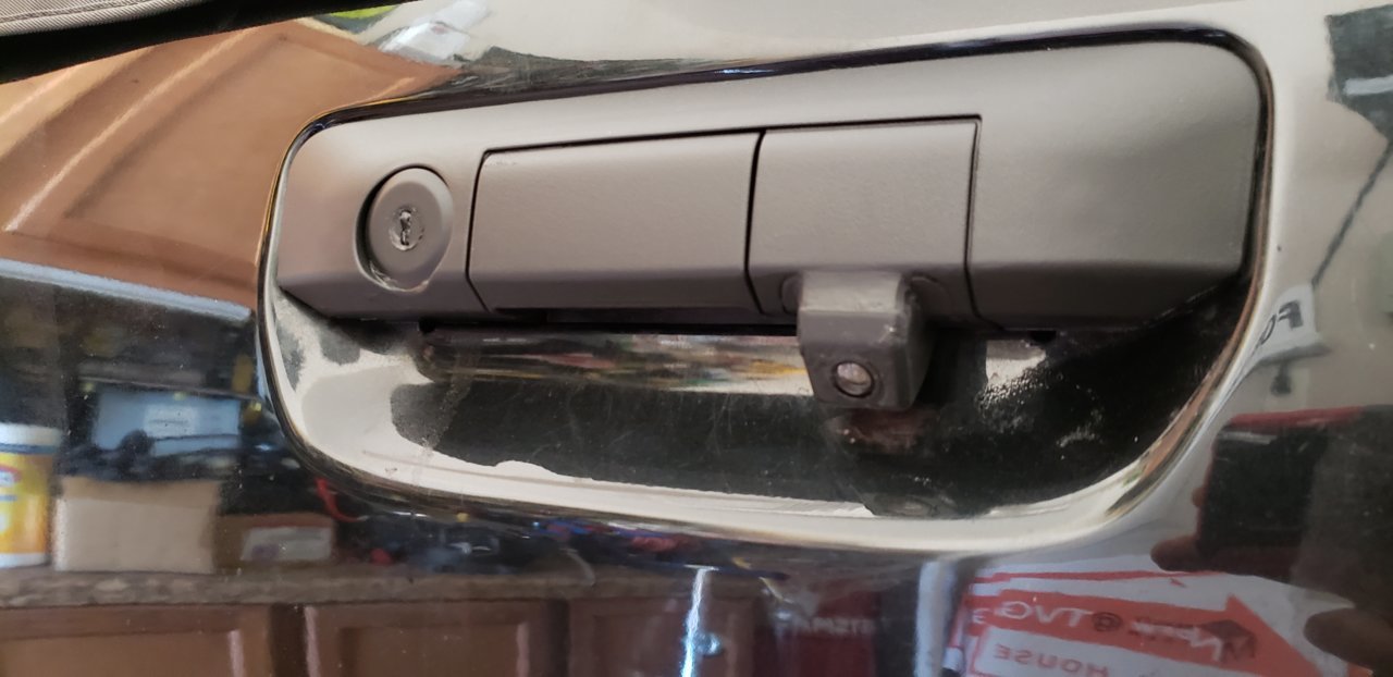

    i have a popNLock with the backup camera and it's a piece of junk. the handle broke on me and they wouldn't warranty it. had to do some redneck engineering to fix it... if theres a better option out there i would take it.

    I swapped the original popnlock with the factory coded one and really like the convenience of one key. I added a backup aftermarket camera on mine.
