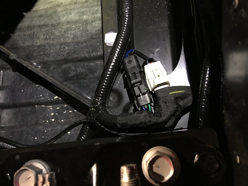

    I placed my connector right by the same connector for the backup camera

    I did too. I removed the clip that holds the wire harness that goes through the bottom of the tail gate. Took a round file and made a filed out section the size of the shielded Pop n Lock harness that goes in the tailgate. I stuck the plug end through the hole used for lowering the spare tire and wire tied it out of the way. I got a reply to my earlier post about where to place the plug that goes up to the front door, wire tied it next to the back up camera connector that has to be undone to remove the tail gate.

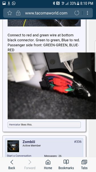

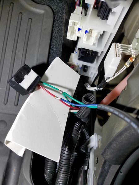

    The Pop n Lock instuctions indicate Blue PnL wire splices to blue/silver streak wire, and Green PnL splices to White/silver streak wire. My harness does not have any streaks on the White plug shown at the top of the block, and only one post here states to splice into the wires from the black connector at the bottom of the block, Green to green, and Blue to red. So, which is it on a '17 Limited 4 Dr??? Hate to start tapping into wires and somehow blow fuses. Seems like PnL should know frankly, and write clearer directions, ie, run the long PnL lead from the back of the truck along the Left frame rail, actually means the Right frame rail from the front of the truck. Have written many many procedures and none written as PnL writes would ever be acceptable. And, I have installed many many accessories on cars, trucks, motorcycles without any problem, so I do know what I am doing given decent directions.

    I think a lot of the confusion comes from people tapping driver or passenger side and not stating which side they are tapping. I ordered the PnL kit over a much cheaper DIY actuator just because i prefer the mounting bracket over drilling my own into the tailgate. That being said my PnL kit is the 8535 and it's for the Tundra not the Tacoma ( i believe everyone's is) since i don't believe they have a different kit for the 3rd gen. All the same the kit itself is the same it's just the wiring that varies. If i remember right they say to go up the driver side through the firewall and most people here say to go up the passenger side through the grommet under the seat. that or through the firewall on the passenger side. Either way someone was nice enough to make a video and post it to Amazon (where the kit is $88 shipped or less) https://youtu.be/KyzdTEV_sBI he went through the firewall which i won't be doing but the wiring is with the passenger doors vs the driver door which is what i do want.
    top plug closest to the passenger outside
    PnL Truck
    blue to green
    green to red
    Then this guy did it exactly backwards of that and it works as well he did:
    PnL Truck
    Green to green
    Blue to red
    https://www.youtube.com/watch?v=x8ZOQpLNq68

    See this is one of those times when there is more than one way to skin a cat, I'm guessing this wiring is taping the passenger rear door and the ones I am referencing is the passenger front or vice versa

    There is a kit for the 3rd gen Tacoma and it has the same P/N as the kit for the Tundra. A member on here posted a PDF of the 3rd gen instructions a while back and just like the Tundra instructions, it states to wire it from the driver's side. I had already installed mine before the PDF was posted, and I used the first YouTube video you posted.
    The P&L instructions say that if it doesn't work properly after installation, to swap the wires around at the actuator. My first actuator didn't have enough throw so it didn't unlock my tailgate because it didn't push the lever all the way to unlock. I contacted P&L and they sent me a new actuator with a return shipping label for the bad actuator. First actuator I had was burgundy, while the replacement actuator was black. When I installed the replacement actuator, it didn't work properly so I flipped the wires at the actuator around and it worked fine after that.
    A lot of members were using that first video for reference around the time I installed mine and some said the wiring was wrong while others were saying it was right. I experienced both, so it depends on the wiring on the actuator in relation to the harness. As long as you're tapping into the correct wires on the truck, it doesn't matter for the P&L wiring harness because all you have to do is swap the wires around at the actuator.
