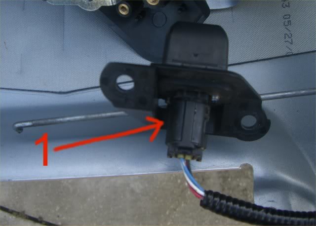

    I am trying to install the pop n lock, and can't figure out how to remove the camera wire harness.
    I noticed in this instructions, there is no step to transfer the gasket from the old handle to the pop n lock handle.

    ok, I was able to get the camera harness off.
    The picture in the instructions was pointing to the left side instead of the underside. finished installing and working fine so far.
