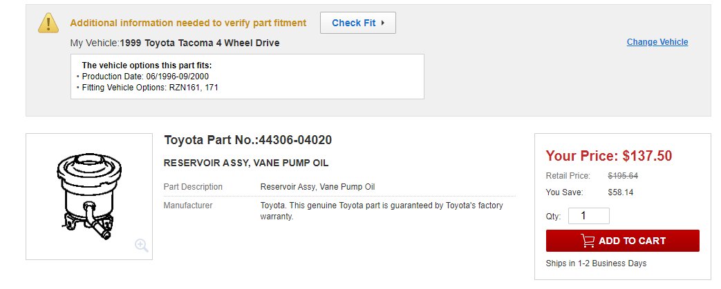

    I recently replaced my steering rack on my 2.7 tacoma and after bleeding the PS pump will not stop whining. I replaced the rack bc of the whine and mainly because it had an awful leak, I was losing all of my fluid in 2 days. Well in an effort to fix the whine (which got much worse after using that gummy Lucas power steering stop leak) I followed this guide below
    https://www.tacomaworld.com/threads/how-to-clean-your-power-steering-resivor.322460/
    After taking the reservoir cap off to clean and inspect the screen, I realized that my screen is ripped, Not sure how this happened because i've never poked at it or anything.
    So my question to you guys is: Should I replace the reservoir? And if so is there a cheaper alternative than oem bc $177 is ridiculous. Or is there another route I can take to fix this issue?
    TLDR; Replaced the rack bc of leaking and a whine. Whine persist so I pulled the reservoir and the screens ripped. Should I replace the reservoir or is there a way to install another screen?

    I would personally be inclined to replace the reservoir, the screen helps filter particles that could cause premature wear on your new rack. You could also just pull the screen and install an inline filter on the return line.
    You might consider getting a used pump/reservoir off of eBay. They can be found in the $40-60 range, and swapping in a different one might help isolate what's causing the whine.

    Again, we are talking about the screen inside the reservoir. You shouldn't have to replace the unit, just clean the screen.
    Same thing happened on my friends Honda Passport. Screen was clogged, so it was making a horrible noise.

    He said his screen is torn that's why he's looking for a replacement.
    If it were me I'd crack that reservoir open and buy a hunk of stainless screen. Cut it to rough size and bend a lip in it to secure it against the sides of the can

    I doubt you'll find anyone on eBay selling just the reservoir. You'll probably need to buy the pump and reservoir together. Search ebay for:
    (1996,1997,1998,1999,2000,2001,2002,2003,2004,96,97,98,99,00,01,02,03,04) tacoma power steering pump "4 cylinder"
    The quotes around 4 cylinder should filter out most of the v6 pumps.
    https://www.ebay.com/itm/Power-Stee...ylinder-Fits-02-04-TACOMA-290051/332754739085
    https://www.ebay.com/itm/Power-Stee...ylinder-Fits-02-04-TACOMA-209057/352975856533
    https://www.ebay.com/itm/Power-Stee...ylinder-Fits-02-04-TACOMA-107099/332840620634

    But in relation to your problem if you can wait a week or two there's a good chance I'll have an extra reservoir you can buy cheap. I'm rebuilding my steerimg system and after I get a new seal kit installed on this donor pump I'll have an extra reservoir
