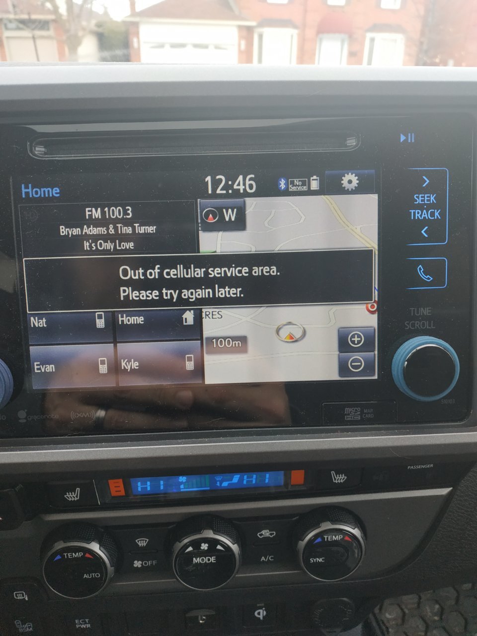

    Has anyone ever experienced this before? I have a 2017 Tacoma Sport. I recently upgraded my cell phone to Android 10. Now when connected to the Tacoma factory stereo, I can no longer make calls from the truck, giving me an error that I'm out of cellular service area. My cell phone is showing full bars connectivity, however stereo shows no service. Any advice/ideas would be appreciated!

    Absolutely, twice. All contacts and messages import no problem. Even the 4 favourites come back ok.

    For what it's worth, I followed the link above, I tired a couple suggestions there, but it didn't work unfortunately. I tried various bluetooth codecs on my phone, but none of them allowed the head unit to recognize I had full bars of service. I can receive phone calls via hands free and the head unit, but cannot dial out. Waiting for Android to push a fix in their software, or someone else who is more tech savy than I to suggest a workaround...
