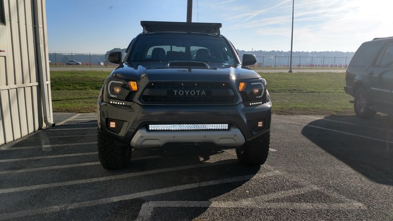

    So far so good. Just curious about how to upgrade the H9's since they are high/low beam. I just want to reduce the heat output.

    I installed the OPT7 Fluxbeam LED H11. They are a single beam bulb. According to the distributer of the projector lights you have, which I think are the same ones I have, the head light has a motorized reflective mirror that moves when you turn the high beams on which in turns moves the beam of the light upwards and that's how you get your high beams. I did install the H11 and turned the high beams on and sure enough the beam moved upwards and wala I had high beams.

    Thank you for the insight. Yes. It does have the motorized mirror. How do you like the OPT7's?? Could you tell me more about them? How was the installation? I'm finding them for about $90.00. Is that about right? Thanks for the input!

    Its a shutter on the inside for high beam. When you switch to high beams a soleniod moves the shutter causing the beam to move. Ergo, you dont need a double filimant bulb. I am curious as well on light output. I did retrofits on my stock lights but recently fried my rgb halos. I was thinking of buying these so I can take my sweet a@# time redoing my stock ones again. You running led, hid, or halogens for bulbs?
