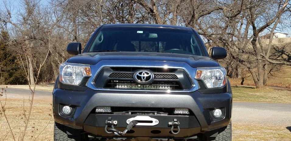

    Old pic, but looks like our weight may be similar. Even have the same winch and both MGM, lol :bananadance:

    The bumper is around 40 lbs and the winch is around 100 lbs.
    Not sure of the sliders weight but they are well over 100lbs.

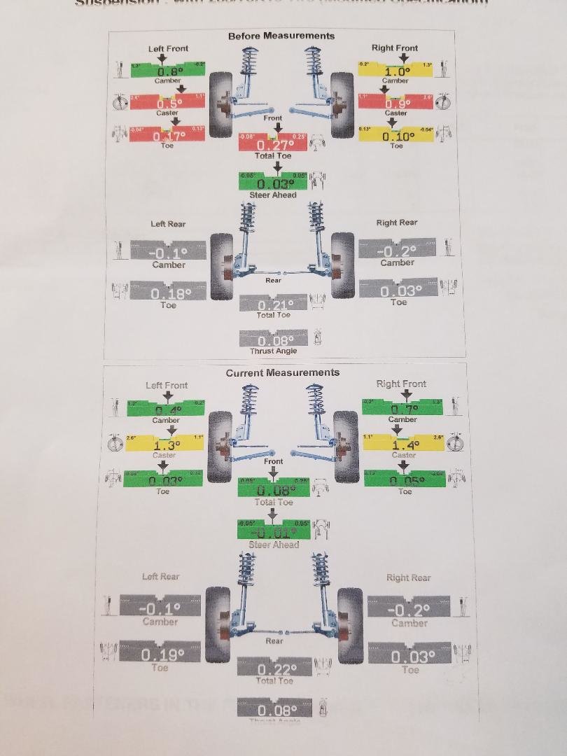

    Alignment numbers from today following the installation of my 255/85-16s

    My billies give me about the same height, i was able to get 2 Caster, but i had to give up a tiny bit of Camber. Which is why i am considering some UCA's. Its not necessary, as i am well in spec, i just hate the look the camber is givin my tires.

    Like this. You have to give up one to get the other. Least i did, hence my earlier note on UCA's. I've had it aligned 4 times since put the Billy's on, :censored:

    Do your tires lean in at the top or out? I can live with giving up a little if it's leaning IN at the top of the tire, leaning out at the top would drive me nuts.
    / \ is good
    \ / is bad haha

    Out at the top. I f'ing hate it. Most people cant see it, but drives me insane. :der: Hence the 4 alignments at, wait 5 alignments, at 4 different shops. And me considering UCA's. Probably the new SPC's, that allow adjustment up top, since i only need a bit. But i'll have to find a tech that knows how to use the damn things or teach them:rofl:
    May end up doing the alignment myself, so sick of dealing with the shops. One dude broke a snap on socket loosening from the wrong side, i had to show him where to loosen. Then he flattened my damn alignment tabs. I wanted to crack him over the head with the breaker bar. I should have left after the first sign. Eventually found someone that knew what the hell they were doing and stayed out there with him. Tried for quite some time, just wasnt possible to get the #'s. I may use him again or just do it myself. How does it go, if you want something done right....:frusty: I try do as much as possible myself, but figured, how could you screw up an alignment right :angrygirl:
