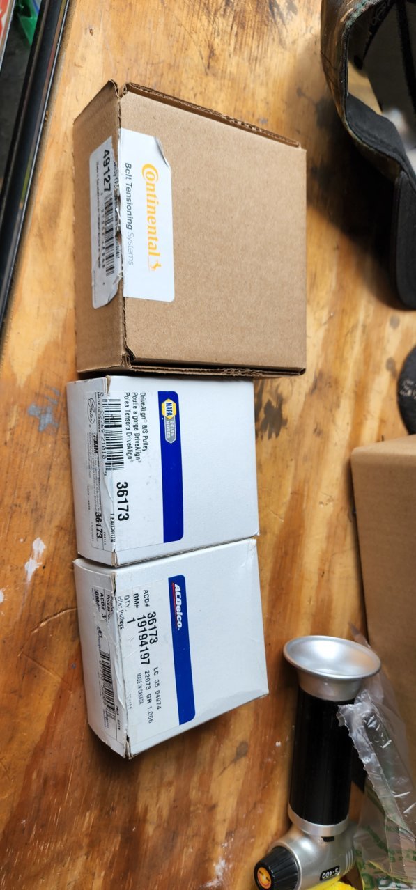

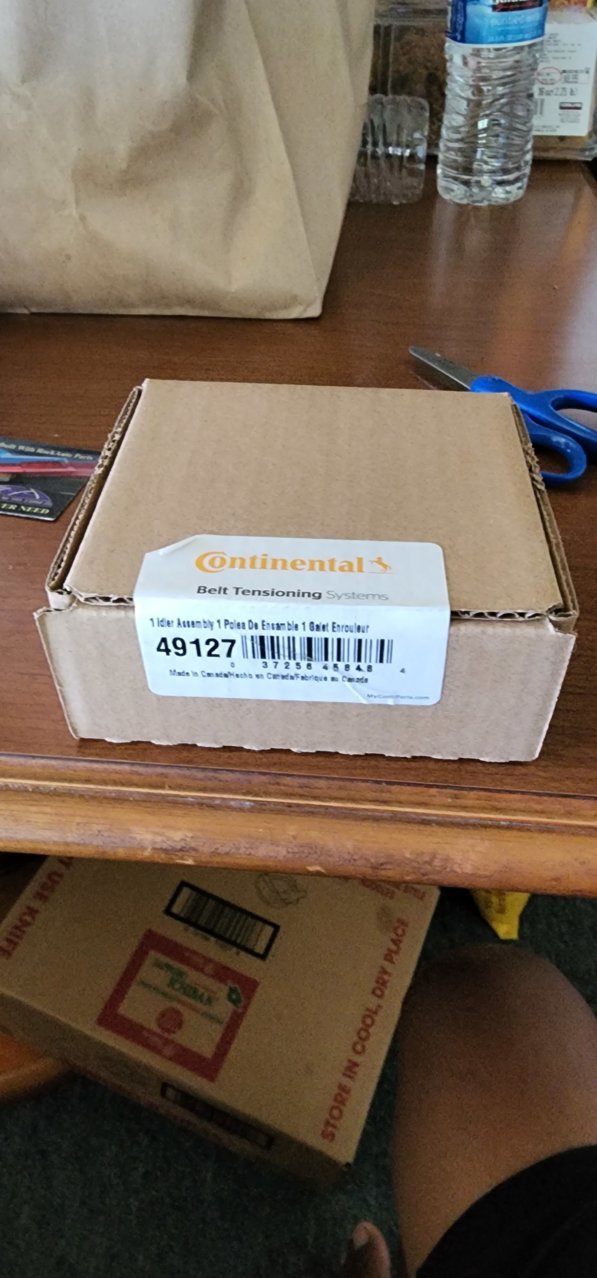

    Bought this pulley at rock auto but just want to make sure it's the right pulley to replace my belt tensioner pulley. 20220722_131104.jpg

    Is that the whole tensioner or just the pulley?
  5. Jul 28, 2022 at 1:15 PM
    TnShooter
    TnShooter The TacomaWorld Stray
    Sep 2, 2010
    #42625
    21,565
    Deogee
    07' TRD Off-Road, Auto
    STOCK
    I looked it up on RockAuto.
    It says it’s the Upper Idler pulley.

    No just the pulley

    Thanks that's what I thought. I do have two upper pulley one from napa the other 2 is from rockauto. One from napa says it's for belt tensioner but it's the same part number as the ideler #2 both upper. Maybe I can use the the 49127 for the belt tensioner.

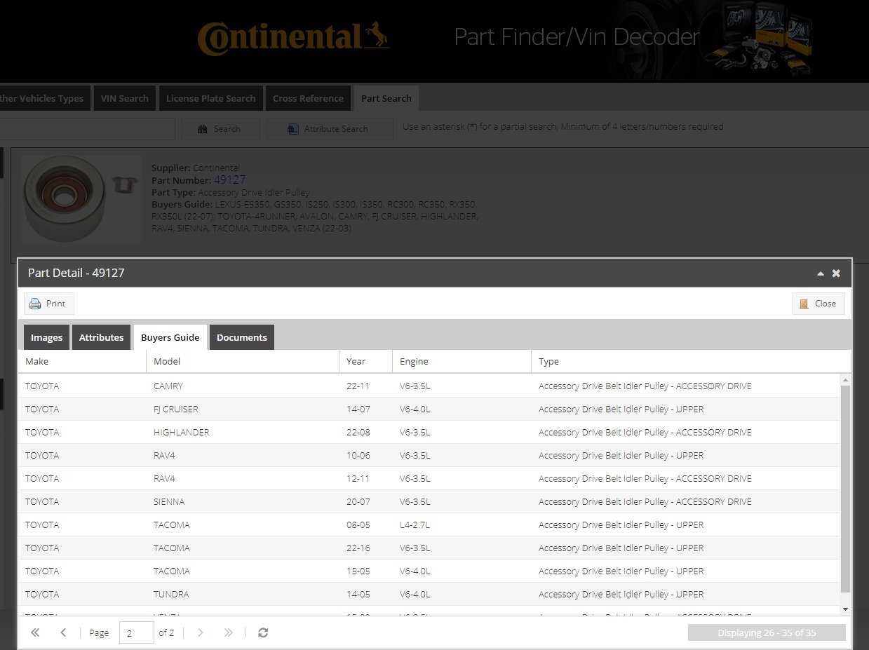

    Yup. I double checked using Continental's Parts Finder Lookup (I don't always trust the info listed by sellers/suppliers so I like to go straight to the manufacturer when I can).

    No, the pulleys for the idlers are different from the tensioner pulley. The #2 idler pulley has an 11mm wide bearing, whereas the tensioner bearing is 17mm wide. The #1 idler pulley has a different offset; you lose thread engagement. Last I heard, Febest was the only company to sell the tensioner pulley, but its a Chinese made part. If the OEM pulleys are not damaged, you can just replace the bearings, including the bearing in the tensioner pulley. See first link above. The second link uses the #2 pulley, which, I point out, has a narrower bearing.

    I was just confused on the part number 49127 didn't match the part number 36173 but they are both same upper pulley #2
