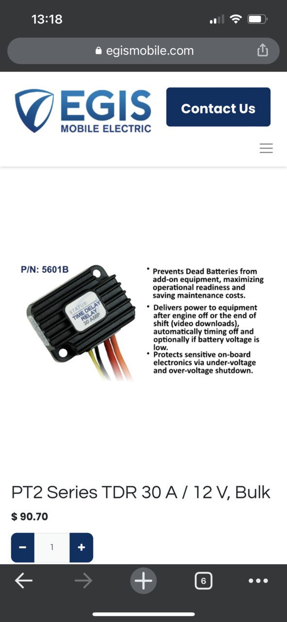

    another option would be to wire in another power source that’s straight to the battery with some fused and voltage drop protection built in.
    Egis makes quite a few options, as do other companies, but in your case, I’d use something like this:
    https://www.egismobile.com/shop/5601b-pt2-series-tdr-30-a-12-v-bulk-5143#attr=
    Yeah, it’s not inexpensive, but it could cost about the same or even more to buy an ignition, key, and anything else that’s needed.

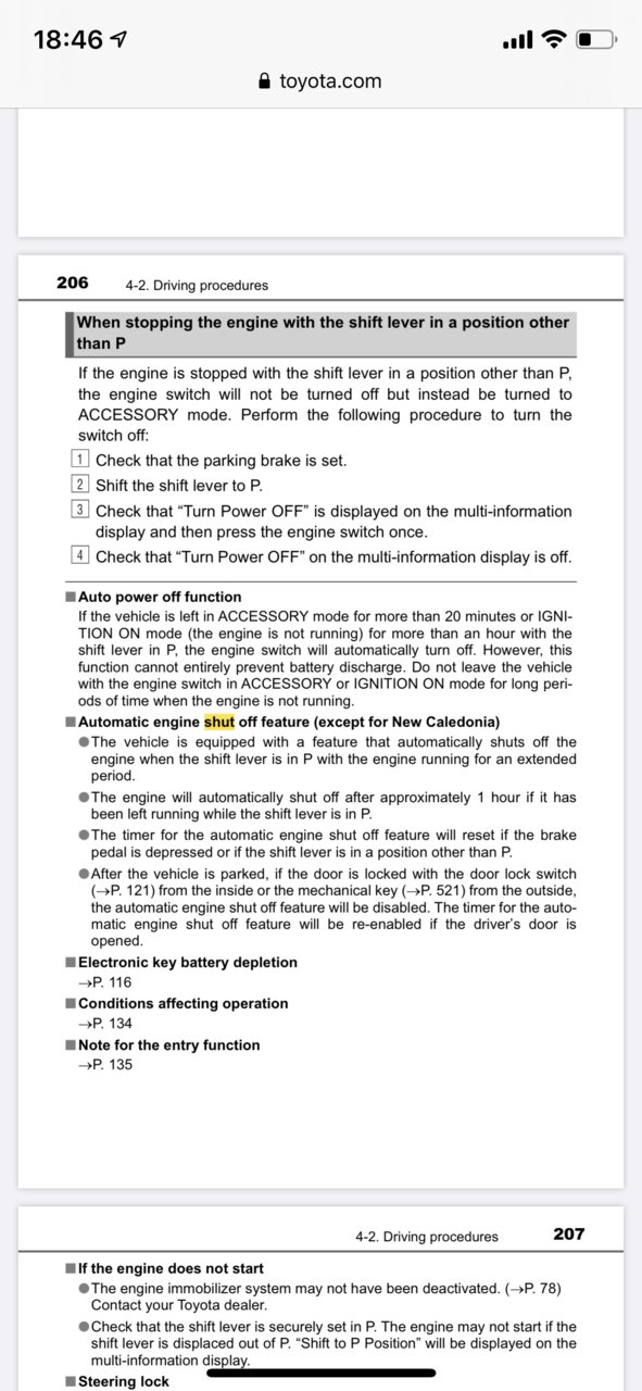

    So, the truck turning itself off after X minutes is implemented in 2020+, it was a quiet addition because it wasn't seen as a big deal. And, for the most part, 99.99% of owners would never notice it.
    How did I notice it? I tried to sleep in the cab in the summer. I needed to run the engine for AC, I thought it would be smart to drive through the country and sleep in the cab in the summer in Texas ..... The truck will turn itself off after some pre-determined time. As far as I could figure out, Toyota never said WHEN that time would be, either it's something the truck implements or they just didn't say it. Again, I don't think there's much secrecy in this, but the lack of information released by Toyota is more so "Who would even care". My method - I found a good parking block, on a hill, and put it in neutral with the e brake pulled. Glad I did - dog kicked the transmission into reverse one night O.O
    For YOU - switching to a key won't fix that. That programming is DEEEEEP in the ECU, I doubt there's a way to change that. You'd have to get engineers at Toyota involved for that.
    Your options are to live with it, or trade it. The manual transmission trucks don't have this auto off feature, and other makes/models don't. But your truck does, and there is NO way to change that. Hard key or wireless key, you're stuck with it.
    This post had something about door locking methods that would "disable" the shutoff, but I didn't have luck with that. But hey, worth a shot. Let me know if it works!
